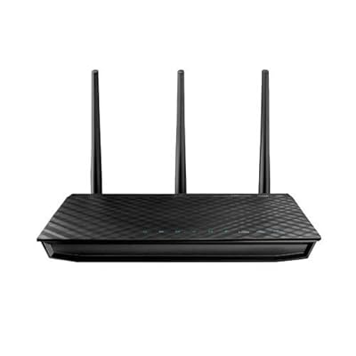

I have this router at my house and at our office (has close to a 100 connected devices…) and it is a power house.
The new lower price is ridiculous :wink:
ASUS RT-N66U Dual-Band Wireless-N900 Gigabit Router
