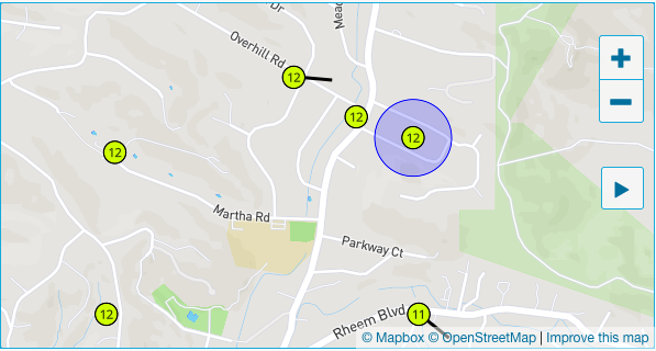

I have a Davis weather station (plus seven Campbell Scientific professional stations) that are linked to CWOP and Weatherunderground, however my Davis Station (KCAORIND146) that has been reporting since 20+ years and is live in all networks (WU, CWOP/APRS, WeatherLink, PWS) does not show up in Rachio anymore. It used to. Digging into this further there are five (5) other stations nearby in WU that are also not showing up in Rachio, the closest showing up is a station that is actually not in other nets and some 3.5 miles away in area with highly local microclimates. This does not work. In fact it is bizarre that even in the large cut out of Rachio’s map barely any stations are listed.
The whole point of Rachio was to connect it to local, ie PWS, weather. Why does this not work? Why are other users having such issues? Why is CWOP not anymore supported? Why can we not force Rachio to accept a specific (own) weather staion by handle from WU, CWOP or WeatherLink?

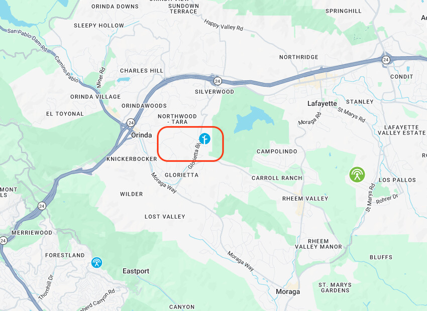

Just looked at mine, and the weather station I’d been pointed to for years at the end of my street has gone missing. Closest personal is now 8+ miles away. That same weather station is missing from WU website as well. Wonder if this is a temporary WU issue, or if they just purged a lot of weather stations for some reason.
Now, today the closest weather station is an airport 11 miles away. Stations that were still there are all gone. This is all garbage and a clusterf at Rachio’s doing. I exchanged several emails with ever more stupid non-technical “solutions” and explanations.

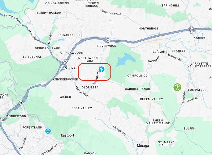

Rachio is pulling the info from WU through API. WU is changing and updating that per their website. I have other APIs pulling and supplying from/to WU and they work fine. Either some programmer at Rachio did not track this, or messed with the code, or tried to find a different/cheaper way to integrate the WU data. My suspicion is that WU (part of IBM), is asking for more money and Rachio did not price that in. So now fiat! Suspicious is also the lack of useable response from Rachio, so they have no support staff to address the issue. WU will issue a new ID every time someone requests a new ID and it maybe people trying to figure out what is going on at Rachio, because that is the instruction customer support sends out. The problem is that Rachio needs to sort this out and not sent out emails for us users to figure out the API issues. I am in the reltaviely well-heeled Bay Area and there are plenty of stations to pick from and the closest they have is 11 miles away.
