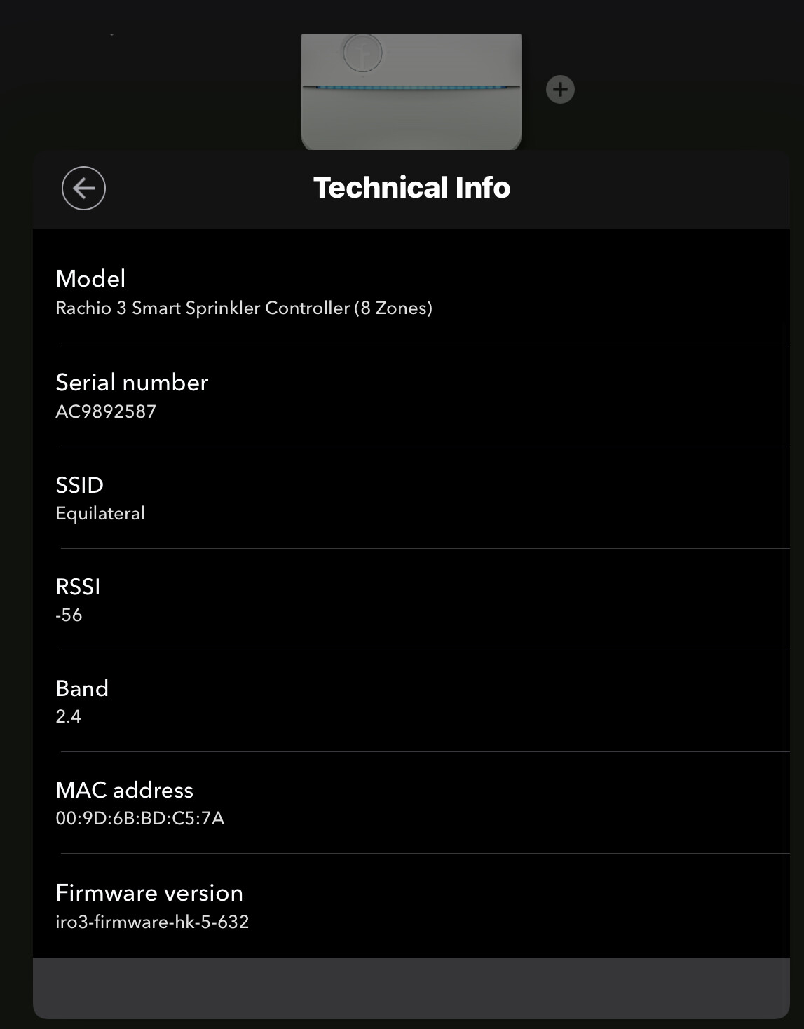

To check current controller firmware version go to:
Rachio App / More (at bottom) / Controller Settings / Technical Info / Firmware version
*The current Controller firmware is: iro3-firmware-hk-5-632

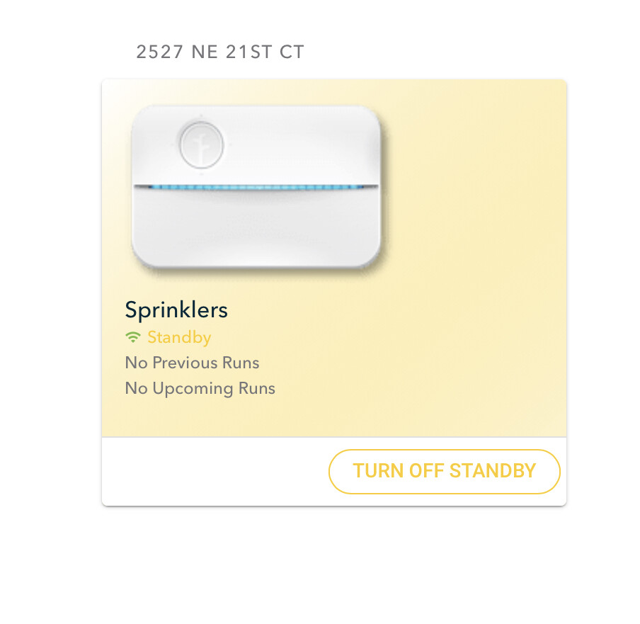

Unless that was old data, it appears to be online.
When you log in from your computer at app.rach.io , does the controller appear in your account? If so, does it show as online? If so, can you run a zone?
Please confirm that you have tried at least two different browsers.
When you mouse over the picture, does a URL appear in the status bar? Does the mouse pointer change shape? When you click on the picture and wait awhile, does an error message eventually appear?
