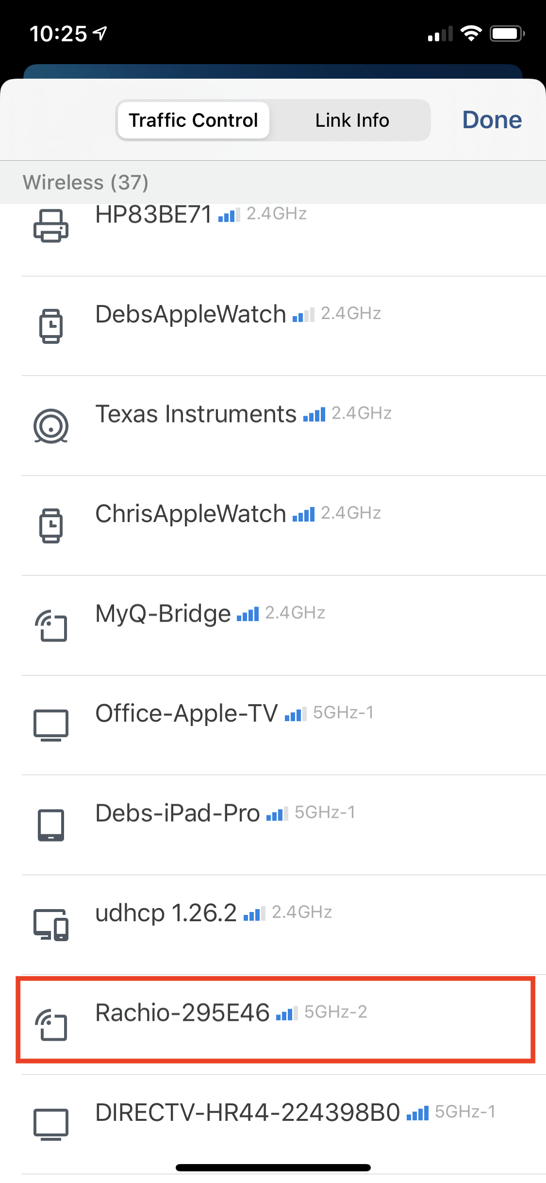

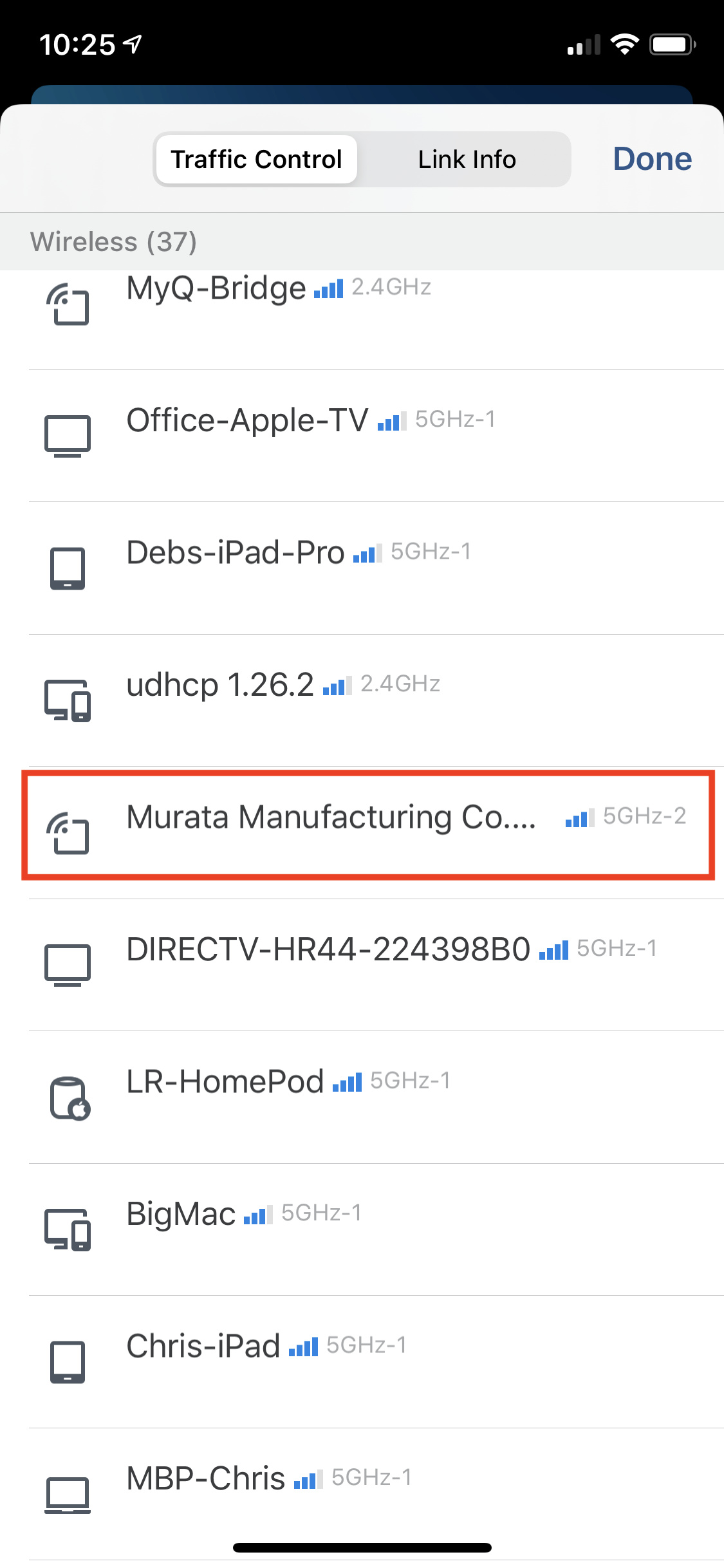

I noticed that the Rachio Controller network name changes from Rachio… to “Murata Manufacturing Company” on a regular basis throughout the day… Sometimes, every few minutes… Hmmmm
