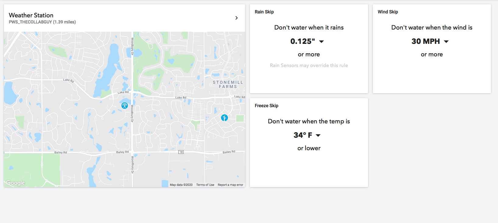

Because this happened last year with a big storm, I was watching the Rachio through the app to see if it was scheduling anything in the week after the deluge. I was surprised to see something scheduled for today.
Here are screen shots from the day after all the rain:
