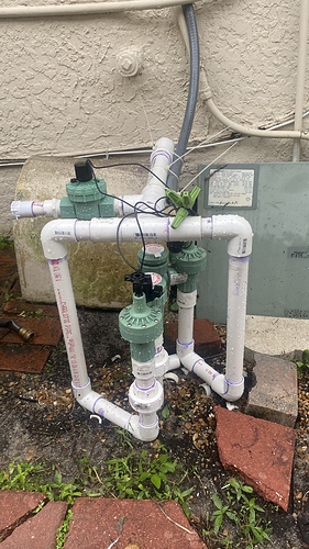

I’ll show you when i finished today with the pipes of what I bought.
Looks great, out of curiosity, what kind of end connector have you used on the new valve at the left of the picture?
It’s 1” to hose. I need to get a hose nipple adapter to use the type of hose i’m using.

The way it is now is for a regular hose. But i’m using one of these hose boxes, so it screws on to the nipple. If that makes sense. Tested after 30 mins. Hopefully no leaks tomorrow after 24/hr if it doesn’t rain.
So you are extending 3/4 tread away from the valve by how ever long the pipe section is? Seems that left section consists of:
valve’s 3/4 female > 3/4 male to PVC > PVC > PVC to 3/4 female
I’d bypass the extension and install the hose adapter directly to the valve, primary reason is to reduce the rotational torque which the hose may apply to the assembly.
Right now it’s 1”x1”x3/4 tee, then 3/4 pvc to 1 inch adapter, into the valve, one inch adapter to 3/4 pvc to 3/4 pvc to hose adapter.

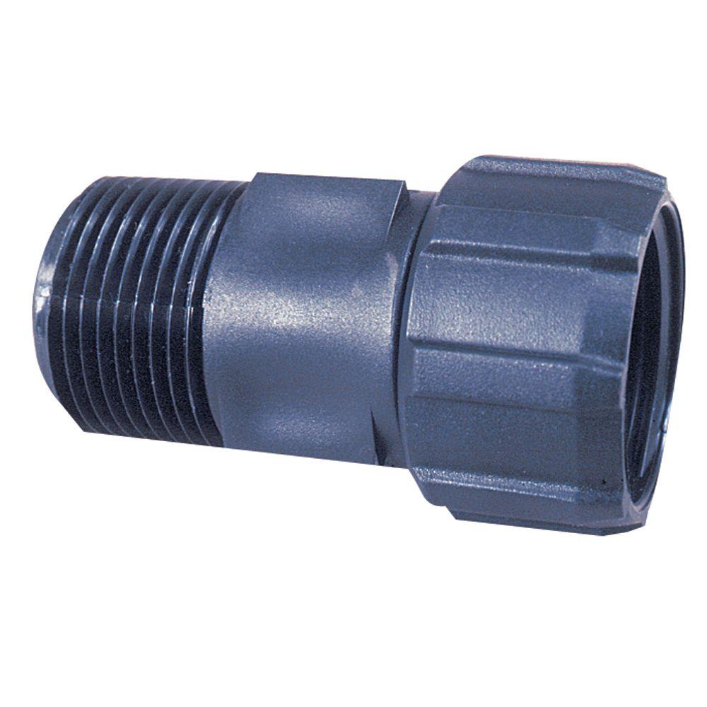

The valve has a screw, so it would have to be hose adapter to 1” screw. Which i can see if they have one
There’s a 3/4 swivel adapter
I’d have to switch out the valve for a 3/4 valve not 1” valve, get this adapter for it to go from T to screw adapter to valve to hose adapter.
Don’t worry about it, what you have will work fine. I just got confused as to the purpose of the adapter.
You can probably replace it with one of these, alas I can’t find one at lowes / hd.
https://www.amazon.com/s?k=1"+NPT+x+3%2F4"+GHT
The reason it caught my attention is that valve is not well supported, and the longer pipe creates a lever, similar to how a wrench can turn a screw, any weight on the end will apply the force to the T which your new valve connects to.
I’m probably overthinking it. The force at the end of the day is not going to be that great.

I have a bunch of left over pvc, I can make a support towards the end if that would be better. How hard is it to twist off the screw when you use screw cement?

Didn’t know about screw cement. Leave it as is. I’m 90% sure that it will never be an issue.
A better solution for you will be to add support, using something like this:

In case the 1 inch version does not fit on 1 inch section of the pipe to the left, the bigger part should be able to go right over adapters. Simply run the pipe from that saddle into the ground and you’ll have a good support
Nice nice, yeah that’ll work, i’ll get it tomorrow, i’ll buy extra pipe too, cause i have cut pieces, long pole would work.
