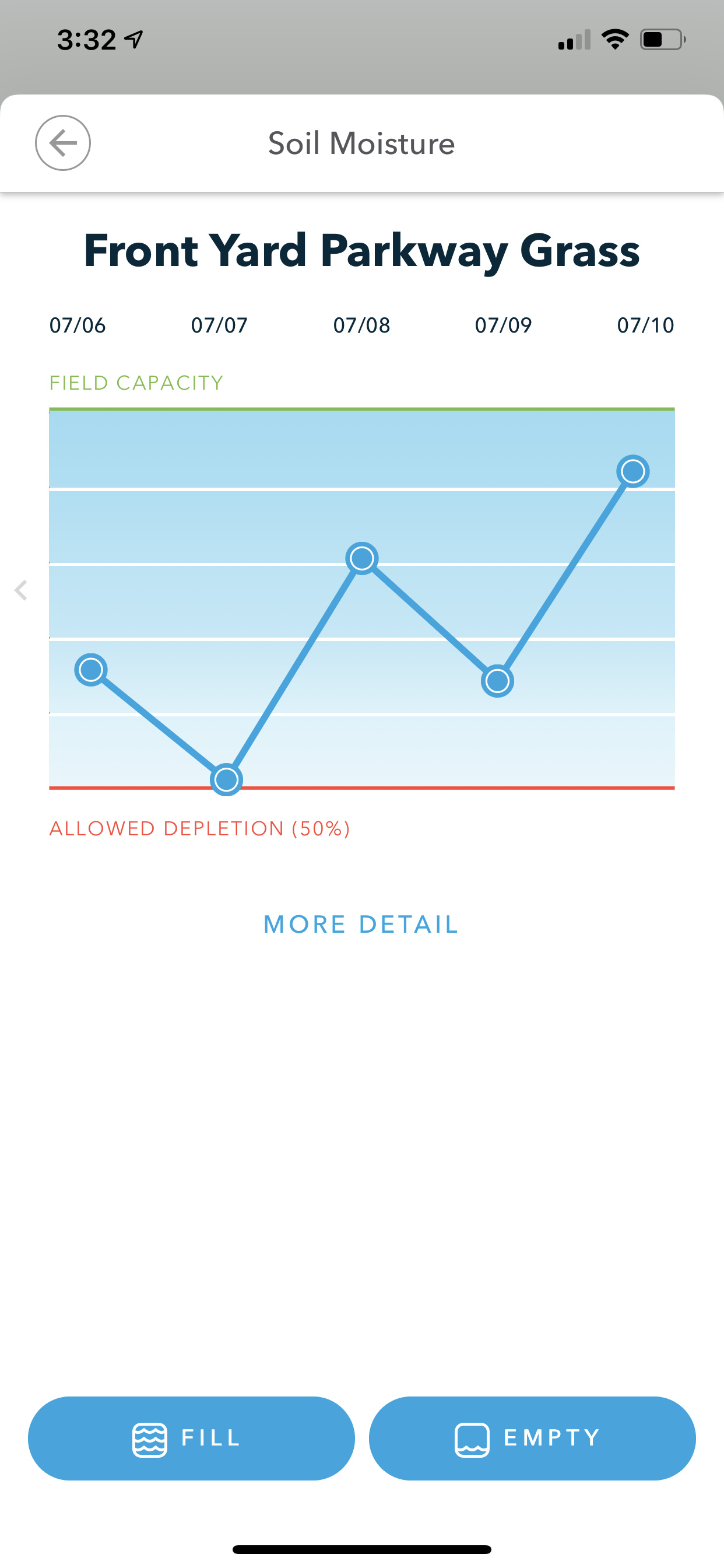

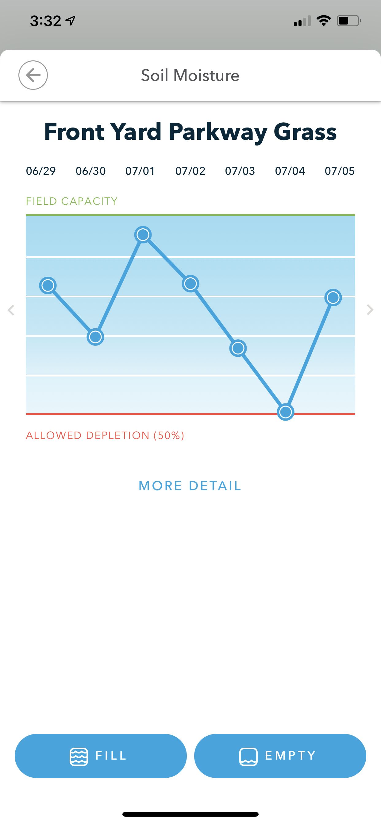

And there is a nice graph that will show you what is currentLy calculated for the soil moisture, when it’s currently expected to be depleted enough that it will need to water again. As you adjust data points that graph would change. And if the weather changes the graph may as well. One nice thing it should do as I recall is if extreme heat is coming it might water a day early because it knows the water will deplete faster. This is especially helpful if you don’t allow it to water on many days. Example. It is schedule to water Tuesday then on Saturday and never on Friday. It sees weather report saying massive heat wave coming Thursday. So it’ll water Thursday because it will know if it waits till Saturday the soil moisture will be depleted further than acceptable.

You can also set one zone to water fixed, one to water monthly flex and one daily flex. Personally I’d go all in on daily right front he start since I’m familiar with them now… but maybe do fixed for half and flex daily for the other half at first till You get used to it if you get one. The key for you would Be letting Go of watering certain amounts on certain days and focusing more on tweaking the data points to keep the moisture level in the range you want, which is determined by all the settings, except adjusting watering times and such manually. Adjusting soil type and water field and root depth and such is far more critical imho to making it work best long term as it navigates seasonal changes better that way.
That should give you an idea of some of the things it shows for moisture level. And you’ll see it doesn’t necessarily need to get it to 100% or let it drop to the minimum either before it will water again. Again it’s kept my lawn greener than it used to be when I water on a set schedule but shorter times more often and even adjusted when it was hot.
The front yard ones are in the sun most the day where the two backyard ones are well shaded.
