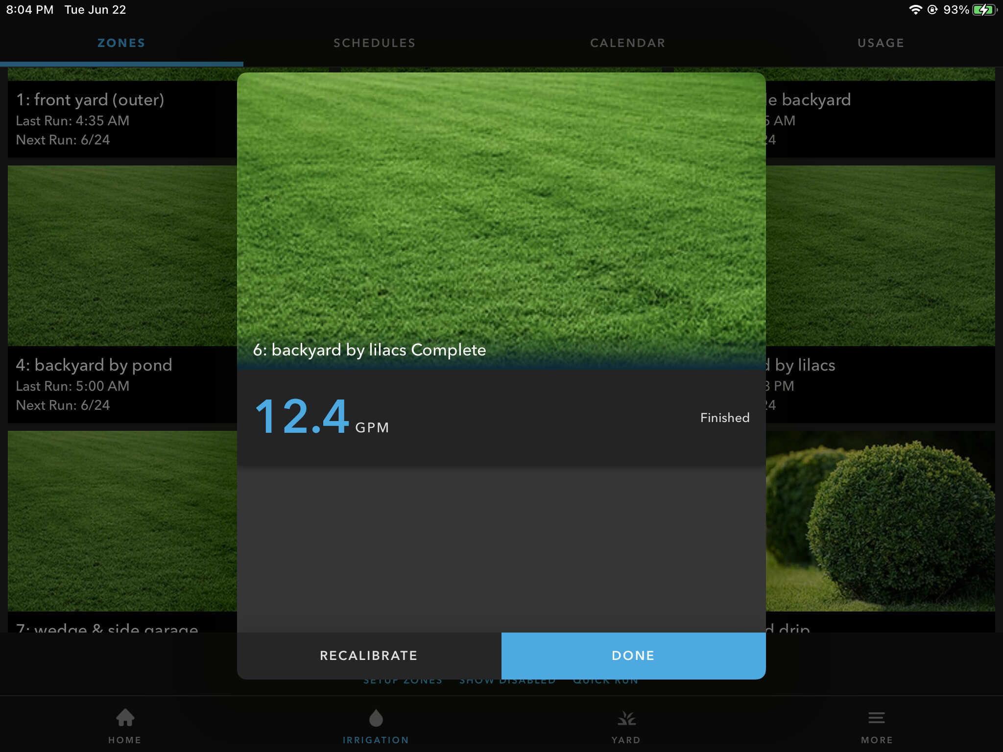

@laura.bauman I’m running v. 4.4.7 on my iPad and I’ll recalibrate one of my zones in the backyard within the next 20 minutes or so (20:00 MDT).
Edit: just finished calibration one of my larger rotor zones in the backyard. Though I had to wait 10-20 seconds before “Finished” appeared, it DID complete the calibration successfully and showed me the computed GPM value (12.4m third screenshot below), but during the 5-minute calibration, as with version 4.4.5, the numeric readout never changed (remained at 0.0 throughout) and the vertical blue lines on the white wave animation never appeared. I reported this as a problem two versions ago (4.4.5) and it was fixed within a day or two in a subsequent release (4.4.6). Here is that discussion thread. Now apparently the latest release (4.4.7) has reintroduced the problem. Below are 3 screenshots in sequence:
