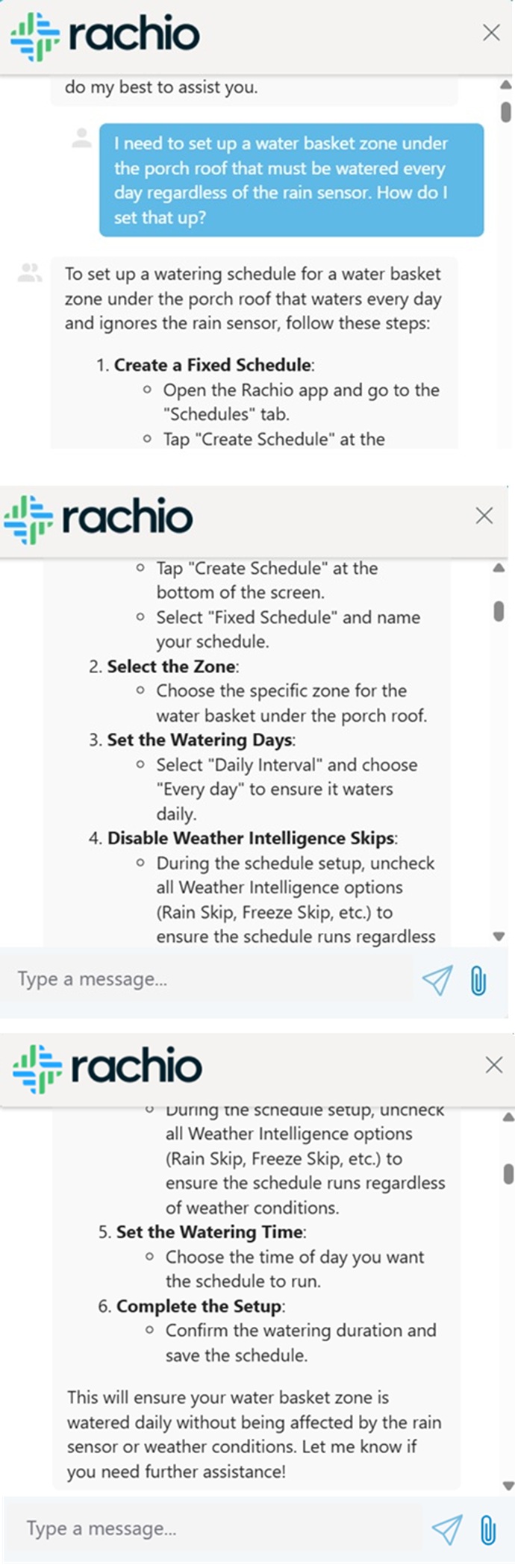

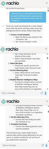

I have hanging baskets on my porch under the eaves. These need to be watered every day regardless of the rain sensor’s state (and WI’s state but WI is disabled for this schedule).
Rachio’s automated help returned the following answer to this question.

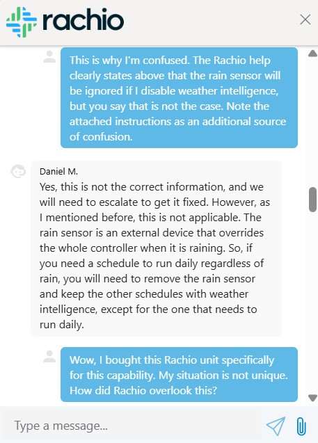

I learned from Daniel, on the Rachio support chat, that this information is incorrect.
That is unfortunate as this solution is exactly the reason I bought Rachio.

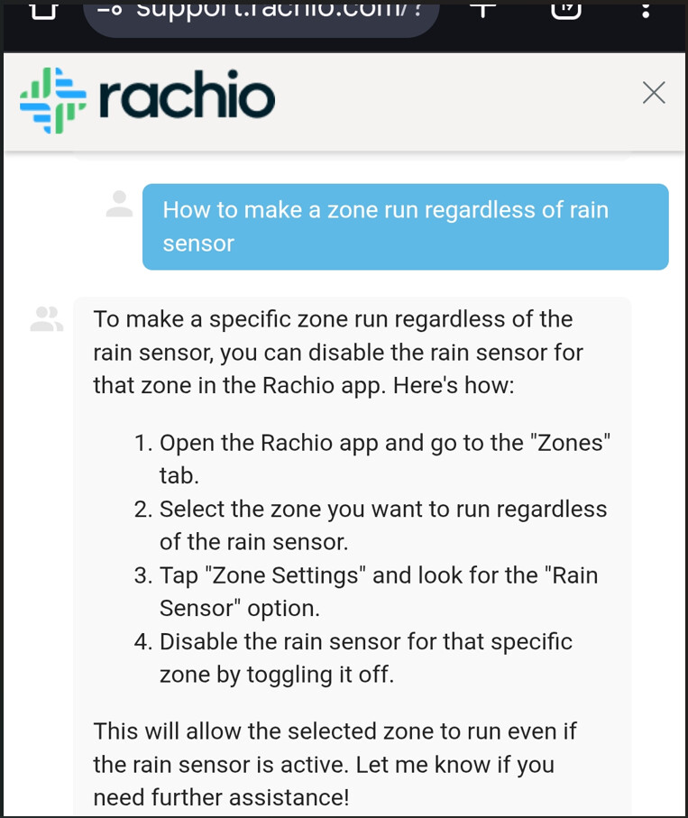

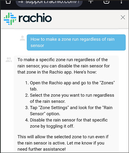

The automated chat also offers this apparently invalid but compelling alternative solution:
Please carefully read the last paragraph.
“This will ensure your water basket zone is watered daily without being affected by the rain sensor or weather conditions.”
Here is Daniel’s response:
Note that his thinking here is “The rain sensor is an external device that overrides the whole controller when it is raining.”
This misunderstanding of the Rachio controller is repeated in this Rachio support doc:
This was indeed the case when rain sensors simply opened the common for all valves.
However, this is not the case in the Rachio unit since the controller, via the app, can complete a Quick Run (open any valve) when the rain sensor is active. This clearly shows that the Rachio hardware,firmware and app software can ignore the active rain sensor.
