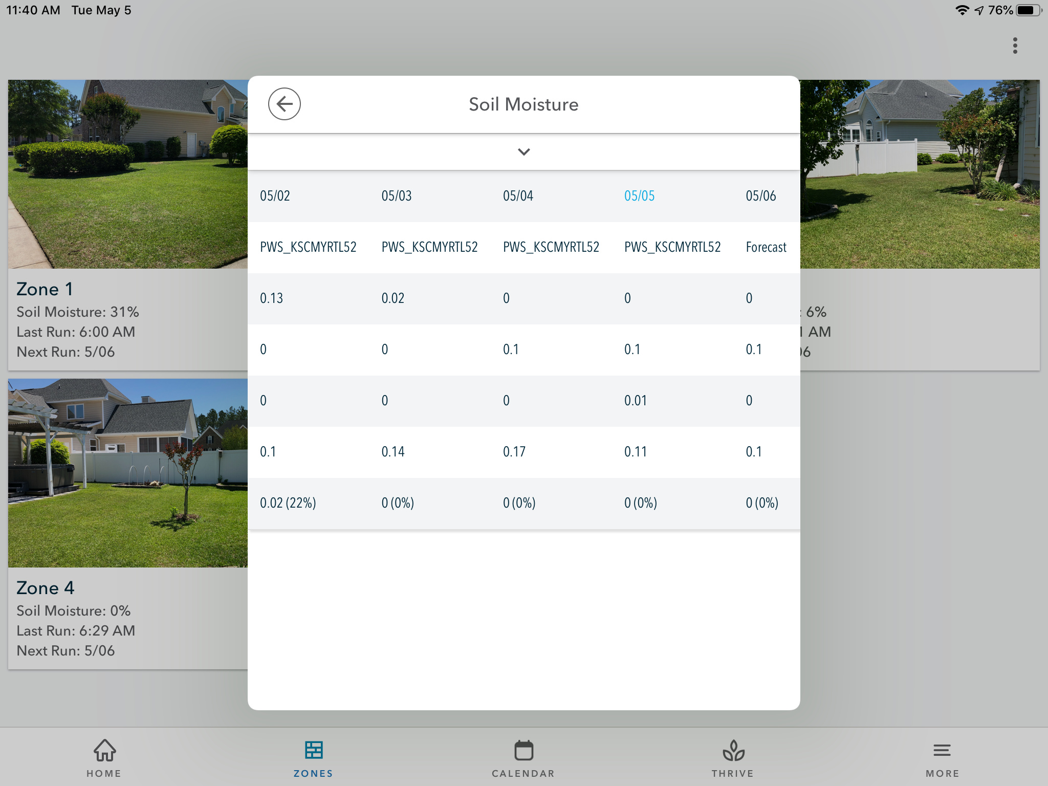

Here is what I see. It could be it just needs some time. I noticed that zone 3 has finally move up to 6%. Zone 4 at zero. Time will tell.
It appears plant water use/evapotranspiration is outpacing the amount of water they’re getting so that keeps the balance at zero. The question is why the schedule is hardly irrigating.
Only way it would be doing that is if user manually adjusted time down in the schedule I would think…no?
That was my hunch. If so, the user should recreate the schedule to get an adequate duration. If it seems too long, we can provide guidance on if it’s fine (reasonable deep watering) or if adjustments to advanced zone settings should be made. Most commonly, the Root depth and nozzle in/hr using the catch can test.
