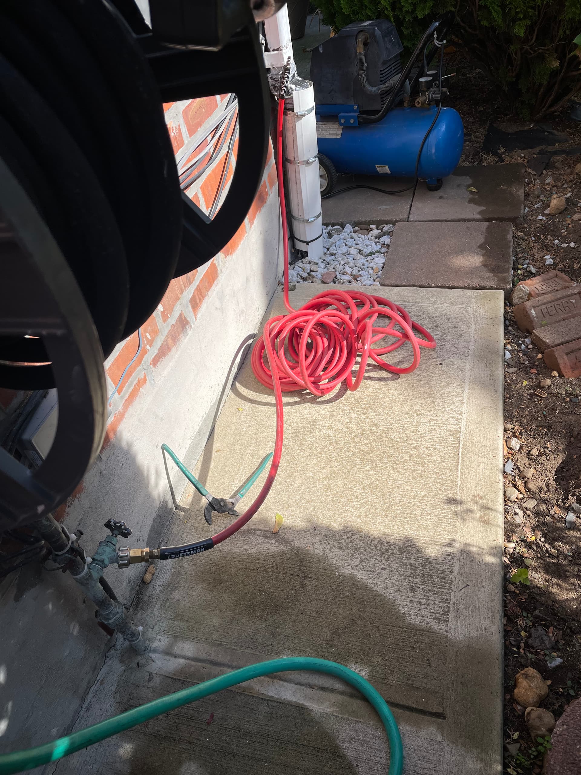

As the winter weather takes over & the temperature plummeting down .. to ( below 40•F :double_exclamation_mark:
@ night ) copper pipes ( especially) can freeze and break open the lines ! Please winterize the Sprinklers using a Compressor @ 60 PSI pressure ( by Shutting the water line OFF) run open the Rachio zones using the App for about 4~5 times …! It will Clear the Standing water :sweat_droplets: in those lines for the next season ! Ready to Start !
This Saves You (:index_pointing_at_the_viewer:).. About :heavy_dollar_sign: 100~150 service using a Professional Irrigation Crews / Lawn Sprinkler Service men !
