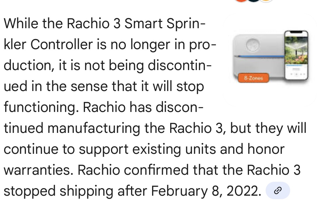

I mean ( for other Products)( calls a Waste of Your :heavy_dollar_sign::heavy_dollar_sign::heavy_dollar_sign:)… However, Rachio is Phased Out ( that I read ) Take a look…,

Well sorta, but not – back in 2022 Rachio was going to change and call things the “Pro Series” , but it doesn’t look like they followed on with that as they are still selling the Rachio 3 on their website. I can see where AI picked up this announcement, but AI stopped there and didn’t look around any more. Yet one more reason I never trust AI!
Here’s the link this came from: Rachio Pro Bulletin - Latest updates for Rachio professionals
Thanks for those updates… here in the forum …, would welcome Newer versions of the Rachio…! Let’s wait & watch …
