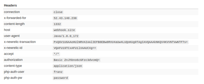

@FlyingDiver I had the team add this to webhooks. I’m not 100% clear on the spec. Is it allowable to POST directly back to the URL that was given including the username:password values? Or is the intent to only have the Base64 encoded ‘Authorization : Basic ZnJhbno6cGFzc3dvcmQ=’ values and not have the username:password as part of the URL?
The user would specify the username:password in the URL they submit to you, but the Webhook client (your server, in this case) converts that to the authorization header as you’ve done above. And does not include it in the actual URL used for the HTTP POST.
