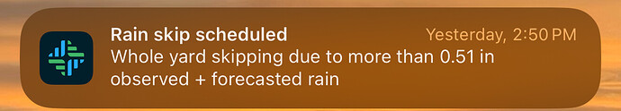

Weather skip changed from the 12 hour notification

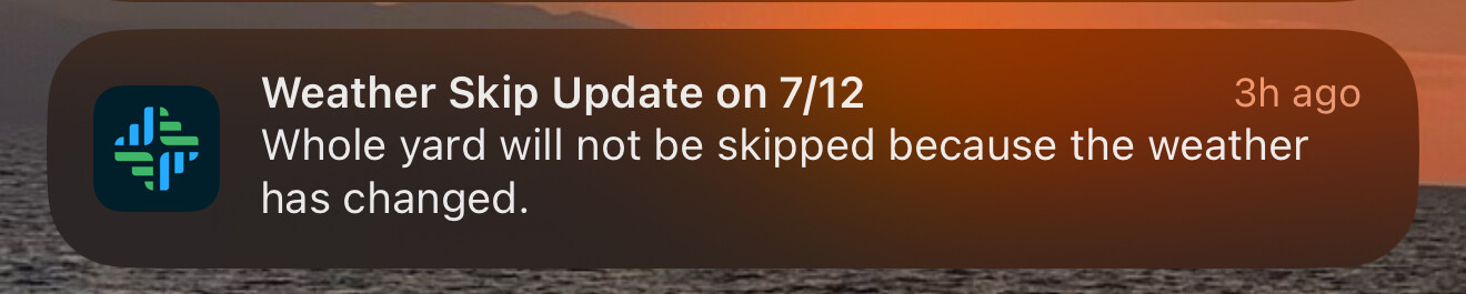

The system constantly waters when the app has told me a schedule will be skipped.
Usually it sends another notification in the middle of the night that says, “the weather has changed whole yard will not be skipped”, then it starts watering. 98% of the time it should not be changing its mind. I’ve gotten to the point on predicted rain skips just manually skipping to make sure it doesn’t water. But why do I need to do that? (Tempest also present on Rachio Account.)
Yesterday it told me in the afternoon that the cycle would be skipped due to soil saturation, then it watered anyway.
I walked the yard with an ice pick and checked soil moisture yesterday afternoon. I agreed there was still plenty of moisture.
So why did Rachio change its mind and waste 2242 gallons (Flume measured) of water?

Sure, the time before this where it told me there would be a weather skip because of predicted rain, then I got the “weather changed” notification just before start time, then it was literally raining hard before sunrise, and the physical rain sensor stopped the cycle. The original “cycle will be skipped” was the correct answer, but then just before start at 2am it decided it needed to water. But before it could finish it was shut down by heavy rain.
Last nights issue is clearly documented in my original post, see the image. Yesterday it told me it was going to skip because of its calculation of soil moisture, but then it watered anyway. I apparently needed to babysit and manually skip.

For the event prior to last night yes. I have no idea why Rachio would think the forecast changed tho. It clearly rained more than 1/2” between 5am and 10am.
Last nights event was based on soil moisture according to the notification yesterday afternoon, again I have no idea why it thinks that was significantly different 12 hours later.

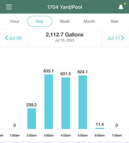

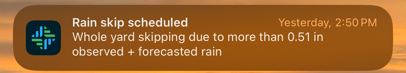

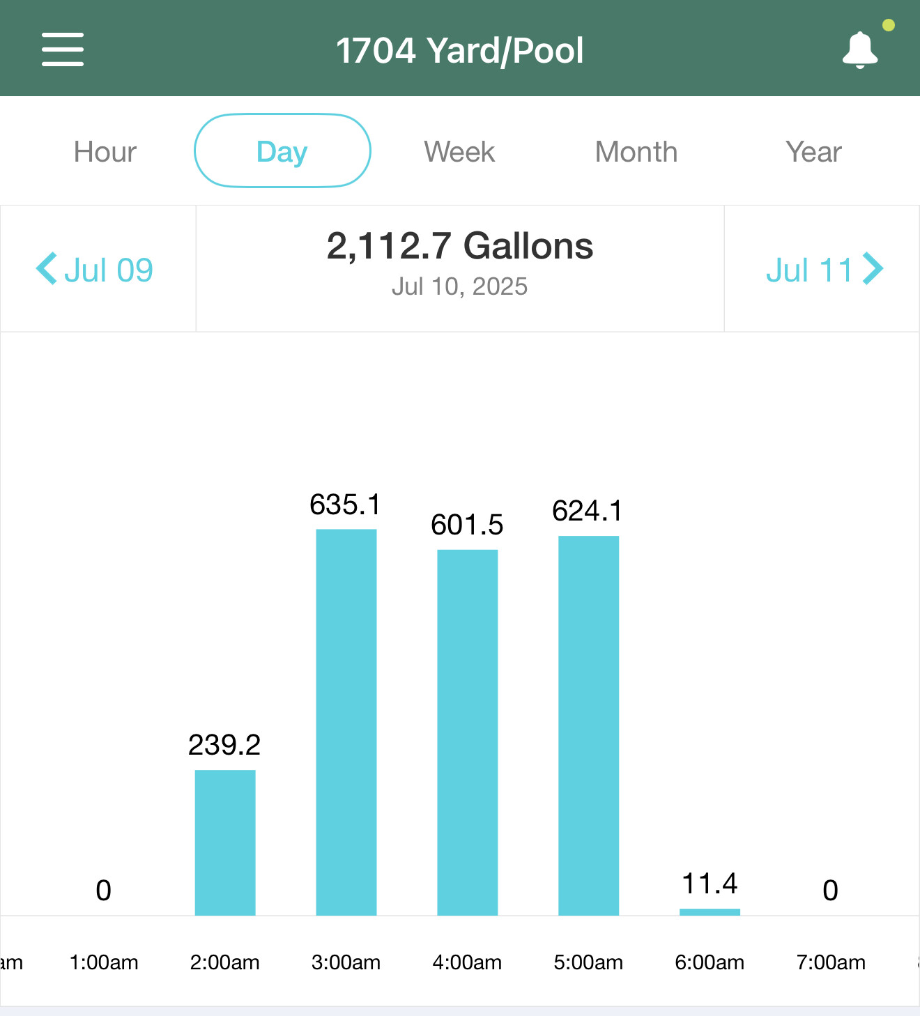

Hi @franz
Here’s some valuable feedback a year later.
Yesterday:
All good with me!

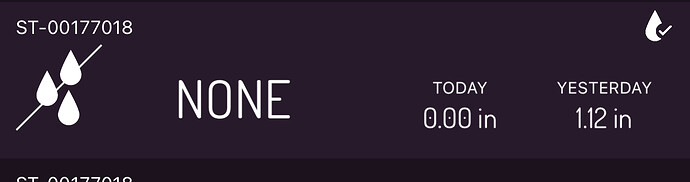

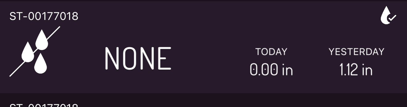

Then 1.17” of rain fell (quantity according to the linked tempest)
Next:
In the middle of the night it decides to water anyway! This is 6 hours AFTER the inch+ rainfall.
Fortunately there is a rain sensor (which I was told I really didn’t need with a Rachio) that was still wet so no water was wasted.
The reason i feel so strongly about reversing watering decisions in the middle of the night is there is no time for me to manually override the decision to pour $33 worth of water onto the yard.
(I pay $16.50/1000 gallons)
