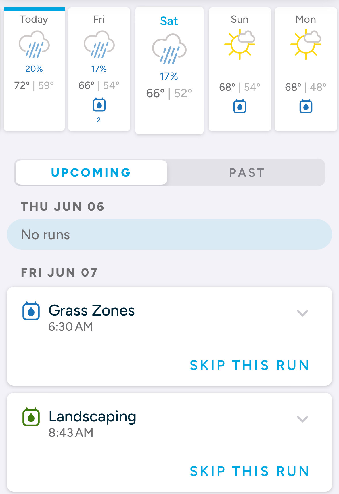

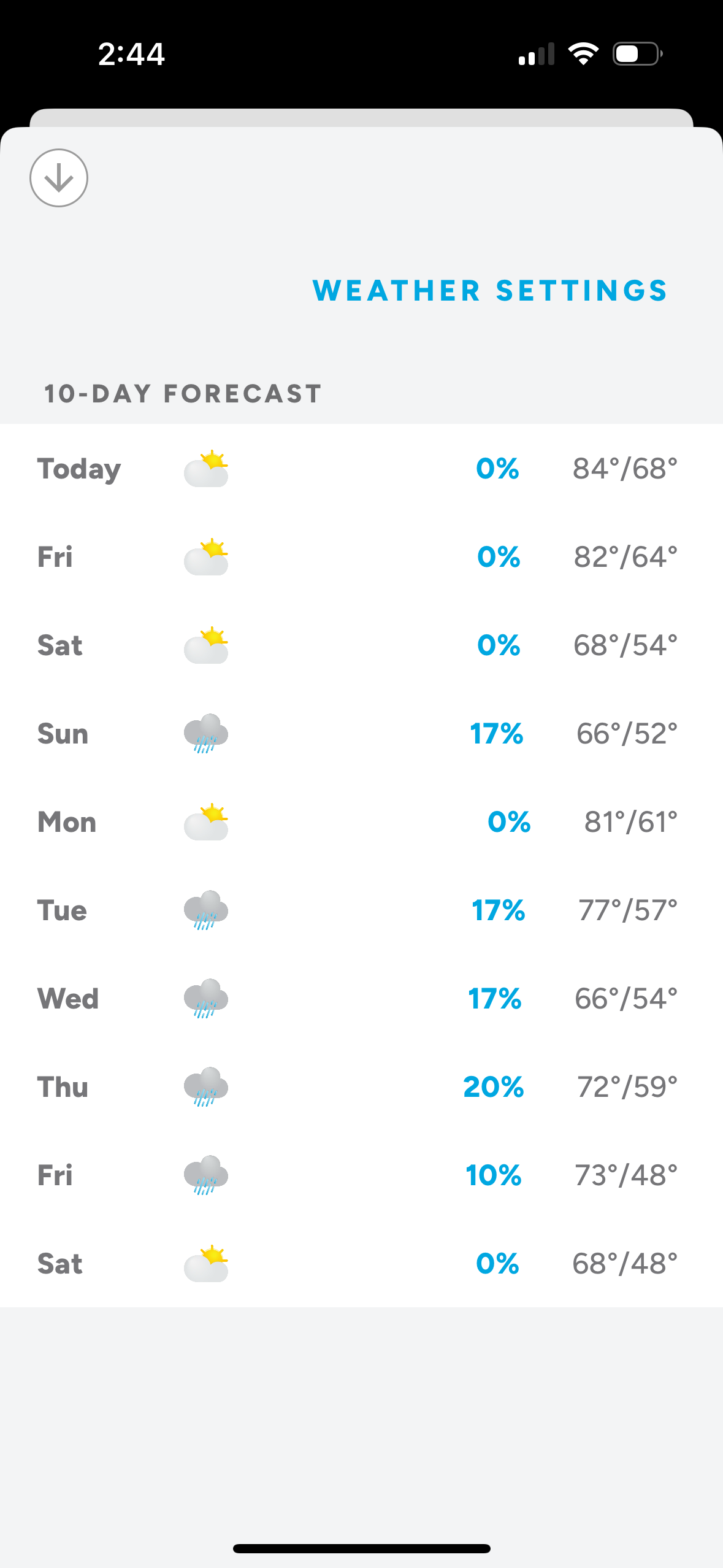

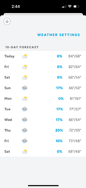

Why are the weather displays between the controller and the smart hose timer drastically different? They are both tied to the same location but as you can see the forecasts aren’t even close.
this reeks of the bug present in the web app. Note how the days are in the right order, but forecast data seems shuffled. Next Thu on the hose display matches today on the controller display with 72°/59° and 20% chance of precipitation. Each day’s data exists in both displays, just under different days :pensive:
Yep I noticed that too. The controller weather seems to be correct, the hose timer weather is random.
