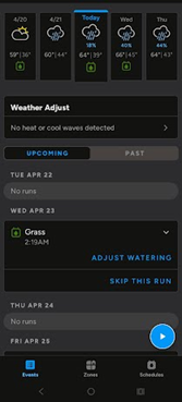

I see a new widget just under the weather & schedule widget (today +/- 2 days) as shown below:
This shows me several things:
  1. Pending: You have no pending weather adjustments
  2. Applied: You have not applied any weather adjustments
  3. Ignored: You have not ignored any weather adjustments
It also allows me to add/edit/delete rules for the following. By default these are disabled, so they probably should be turned on for EACH zone you want to enable them for:
  1. Heat Wave Rule
    • Increases schedule run duration when hotter weather is detected
    • Default when enabled: If temperature is about 105°F for at least 2 days, increase zone run durations by 20%
      • Bold values may be changed
      • Additional options (default is disabled)
        • Water every day during a heat wave
        • When triggered, apply the adjusted durations to my schedule automatically
        • Restore Default
  2. Cool Wave Rule
    • Decreases schedule run duration when cooler weather is detected
    • Default when enabled: If temperature is below 61°F for at least 3 days, decrease zone run durations by 20%
        • Restore Default
