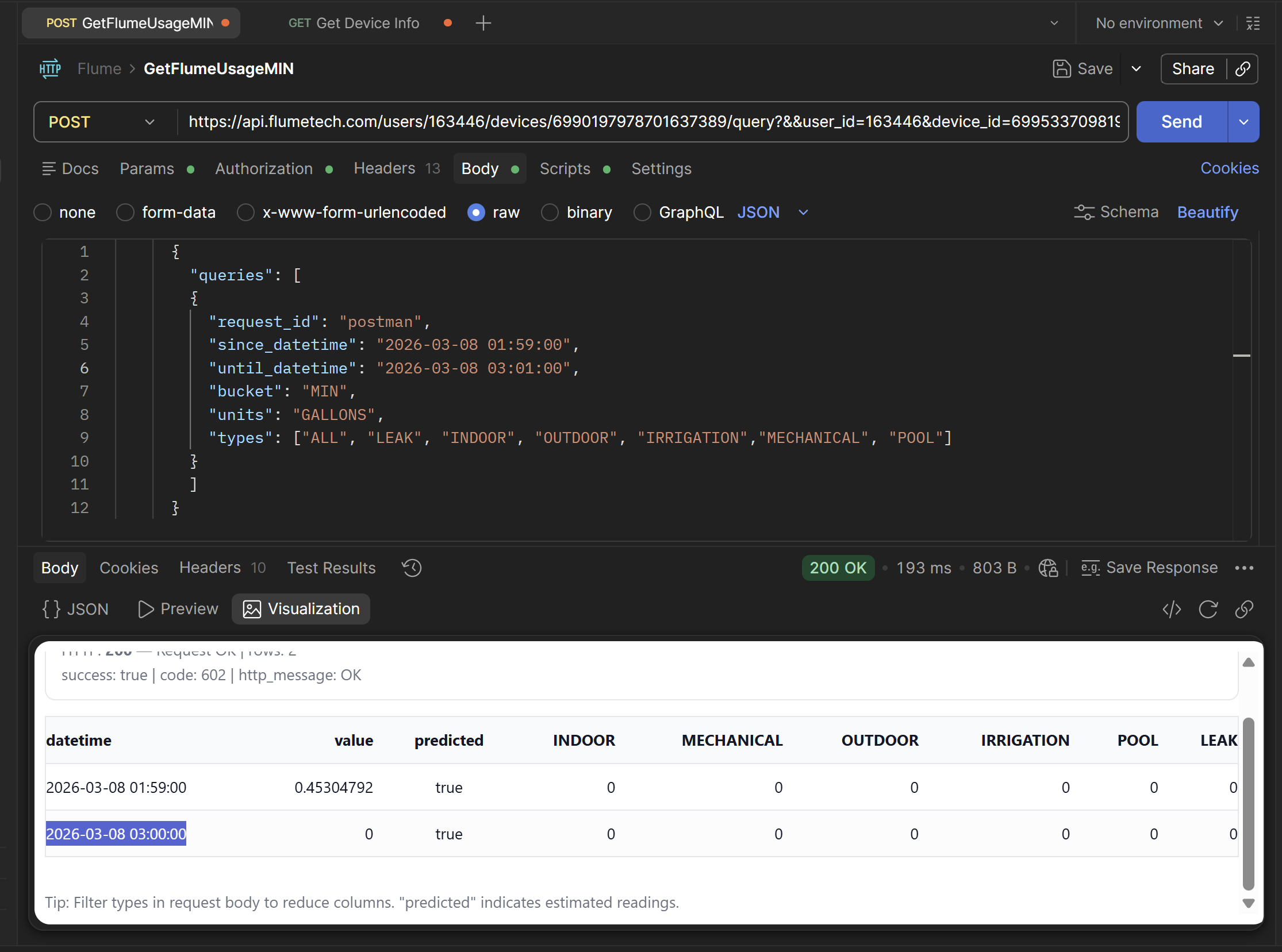

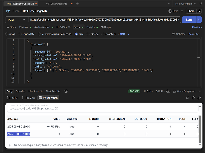

There seems to be a bug in Flume APi that skips the hour (2:00 am on 3/8) when the clocks change (Daylight Savings)- see below. Did you experience this and/or have a fix???
