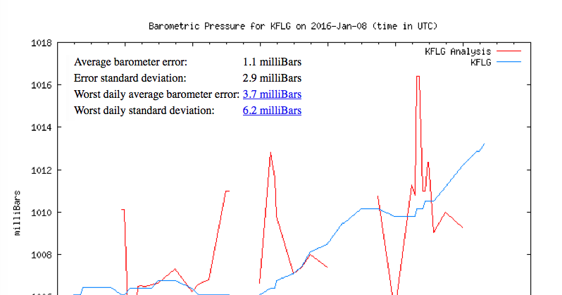

I’ve used this in the past and it may have the station you are looking at for validation.
This article will help you find the PWS station online and get much more data regarding it.
