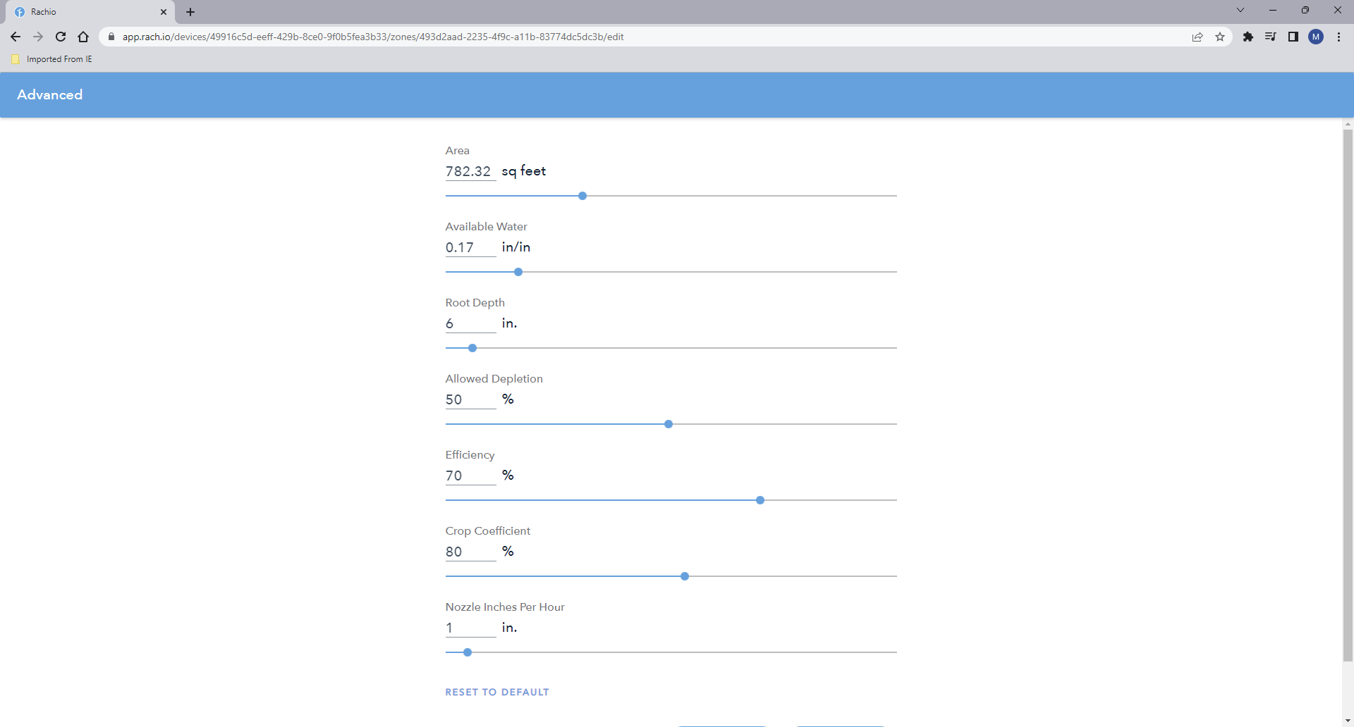

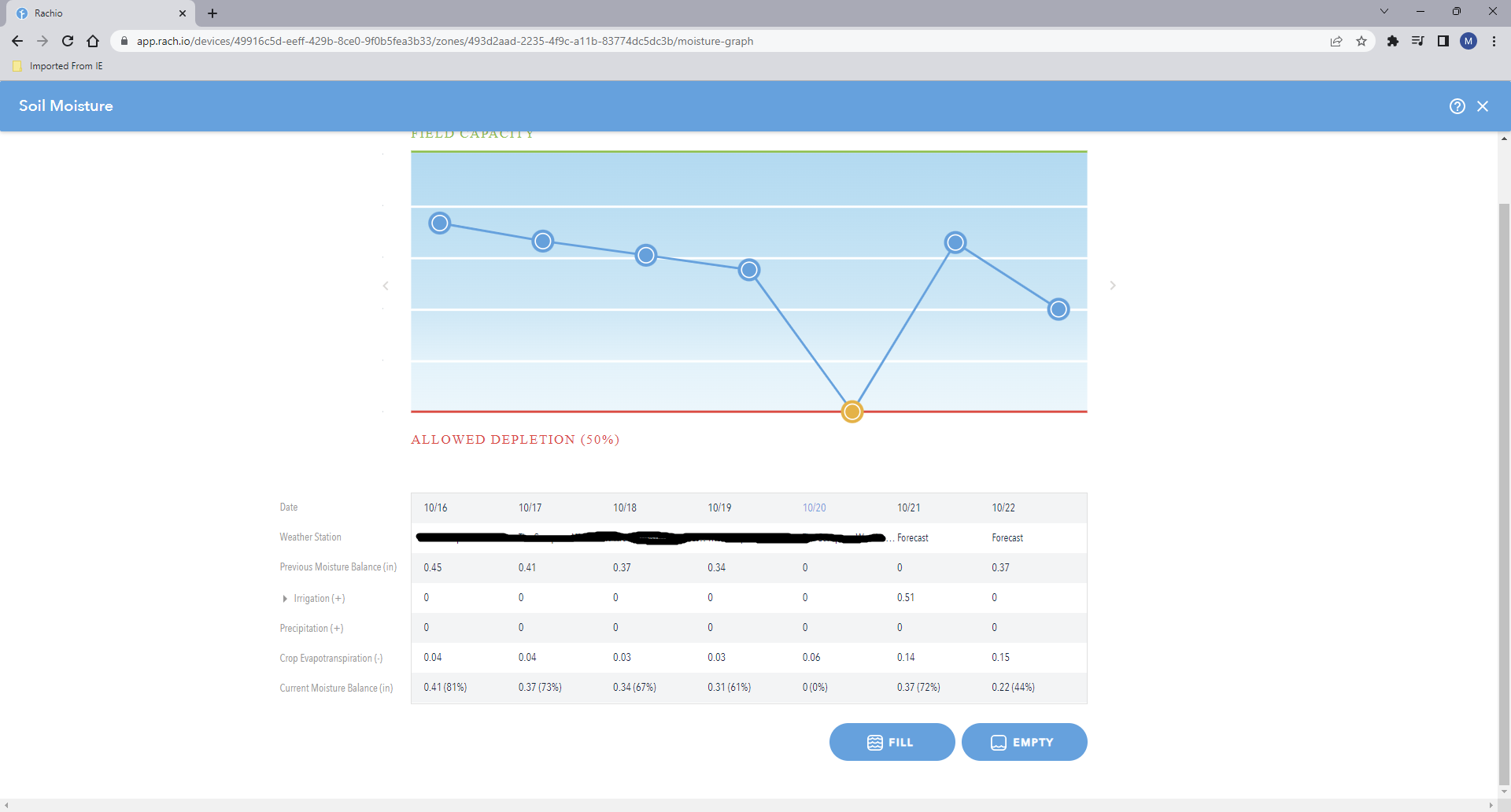

I currently run a flex daily schedule. All of my settings are set at default. During the summer, my system would run for 3hrs and 14min 2 or 3 times a week (depending on temperature, rain, etc.). Now that we have shifted into fall, my system seems to be watering way too less. For instance, my system ran on 10/9. Since then, my Tempest has only registered .48" of rain. My next watering is not scheduled until 10/22. That’s a total of 13 days before watering. That doesn’t seem right. My grass has started to brown a little in spots and is not nearly as green as it was during the spring and summer. From what I’ve read and understand, my grass is supposed to receive 1.5" of rain a week. Since fall, I am nowhere near getting that much water on my grass.
Does something in the Rachio code change when progressing into the cooler seasons? Outside of totally deleting my schedule and re-adding or manually emptying my zone soil moisture table to kick off my schedule another time during the week, I’m not sure what other options to take.
