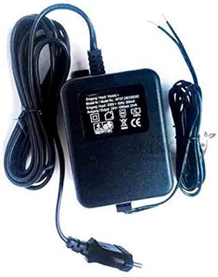

Here are a couple of options which show up on amazon:
I’m very sad. Don’t know what to do more.
I’ve bought the first option you recommend me. Is the one of the picture 2. It doesn’t work. Nothing happens. No light on.
If I use the one of the picture 1 the blue light turns on and it works, except it can not stop.
I wanted to send a video I have made but this page doesn’t allow to attach videos. If you have an email I can send you and you will see what happens. What can I do? In some days I’ll plant my grass and I need to resolve it. Thanks
I see no good reason why controller would power-up with the DC supply from picture 1, but not the AC supply from picture 2. From the look of things, voltages and the plug sizes on the second supply match what is needed.

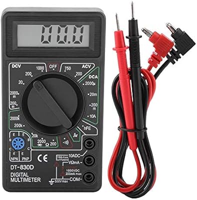

I would suggest getting a multi-meter from your local home improvement store, something like this:
This will allow you to check if the AC supply you’ve ordered is working.

I have the tester.
As you can see in the pictures, the first power supply I’ve tested is the alst one Ibought in amazon 2 days ago, the one you recomended me. As you can see it seems it works (gives 28.2 V)
The second picture is the Power supply that I bought at the beginning and it works with my Rachio but can not stop. As you can see it seems it works, it gives 24.4 V.
I d’n’t know what to do more. I think the Rachio machine has a problem, because it seems the power is not the problem. What do you recomend me? THANKS fot your help!!!
