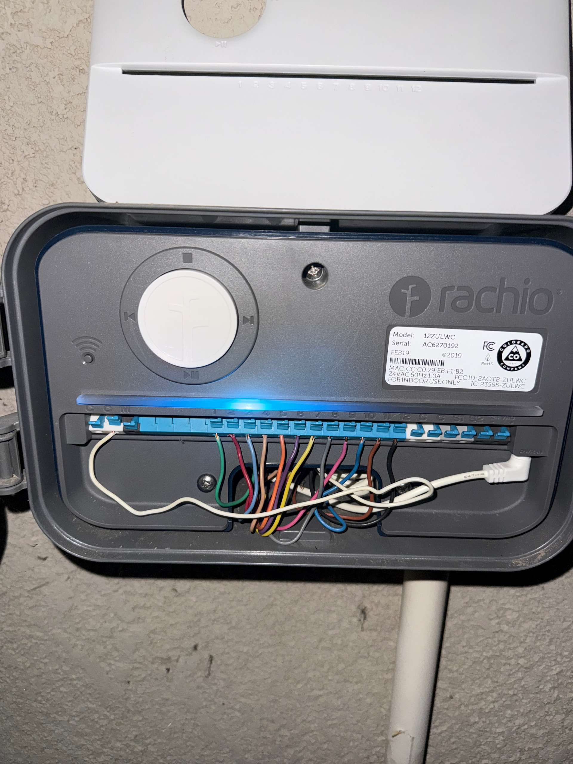

Looking for some help. My water supply is open. On the App it says it is watering when I do a quick run with any zone. But it doesn’t actually turn the sprinklers on. When I turn the valves on manually, the sprinklers turn on but not when I use my daily schedule quick run. Any help would be greatly appreciated.
Thanks.
@jamalishida - by chance do you have a rain sensor in-line on the common wire? If so and it has rained recently that could be the reason.
Any digging in the yard that would have cut the field wire?
Get a multi-meter and test the resistance down the common wire to a zone when disconnected from the Rachio to see if there is a complete circuit.
