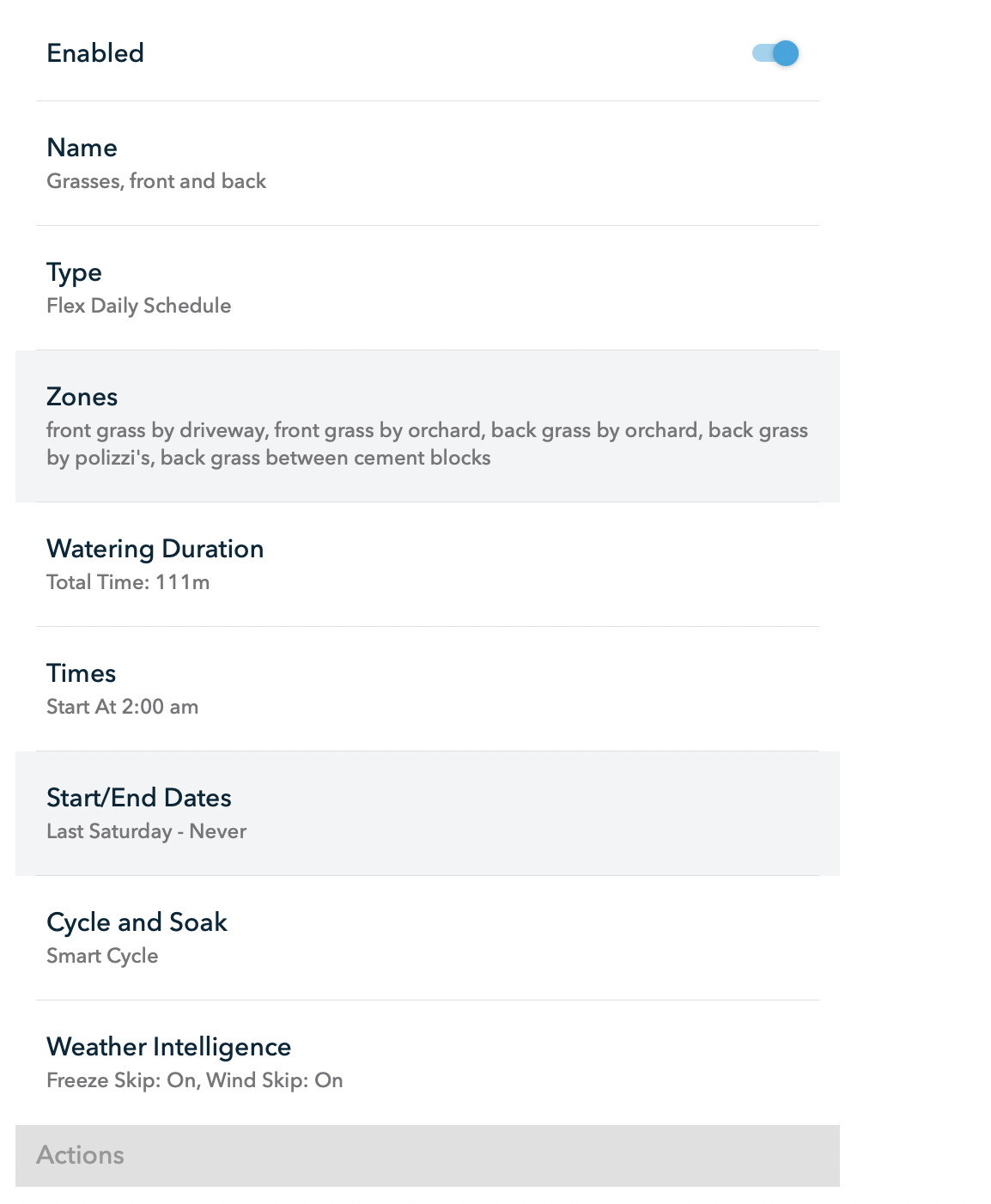

I’ve attached screen shots for review. All zones are set up the same. Lawn was aerated and fed two weeks ago. Working with Rachio support we emptied the zones so that we could see a baseline. I also deleted the schedule and created a new one. Thanks in advance for your help.

Your Advanced screen looks okay. 0.95 Crop Coefficient seems a little high, but I’m not as familiar with St. Augustine. Other values seem good.
I’m assuming you’ve changed some things in the last few days, as a 0.16" change in moisture balance increased the % by 51% on 8/27 or 3.19% per 0.01", a 0.5" change resulted in 97% increase or 1.94% per 0.01" and a 0.33" change increased % by 65% or 1.97% per 0.01". So looks like something got changed about the zone about 8/28. And I assume you watered manually on 8/29 for the 0.77" or Rachio was catching up. But the 0.51" planned for 9/1 is correct per your variables, so think you should be okay there. Also, based on your average ET (Crop Evapotranspiration) for the week of 0.19 (1.32 total divided by 7), the 0.51" of water should be applied about 2.6 times per week (every 2-3 days) which sounds right for hot weather.
That sounds good. The only other concern would be the Nozzle Inches per Hour. For the Rotary Nozzle you’ve selected, Rachio defaults to 0.7" of water per hour, while you have 1.5" per hour. My experience is actual nozzle flow is often lower than Rachio’s defaults, meaning it could be lower than 0.7". Where did you get 1.5" per hour? Using that flow would result in half the time and water being applied that Rachio would recommend. You may want to consider measuring actual flow by using Catch Cups or measuring Water Flow & Area.

Linn, I had changed to .95 in order to get to the times I thought needed ie: I wanted the lawn to be watered longer/less frequent in order to get the roots to grow deeper. Rachio is kind of a maze…or maybe it isn’t meant for St Augustine:)
A higher Crop Coefficient will water more often, but it will NOT water more/longer at one time so won’t make the roots grow deeper.
I’d prefer you adjusting Flex Daily correctly (which it looks to me like you’ve done) and let it take over. Then adjust the Crop Coefficient up or down if the lawn is too dry or wet. Flex Daily takes into account actual rainfall and changes in weather, while a constant 30 minutes every 3rd day does not. As I mentioned above, I’d expect Rachio to water with your current settings about 2.6 times per week, so you’re close.
