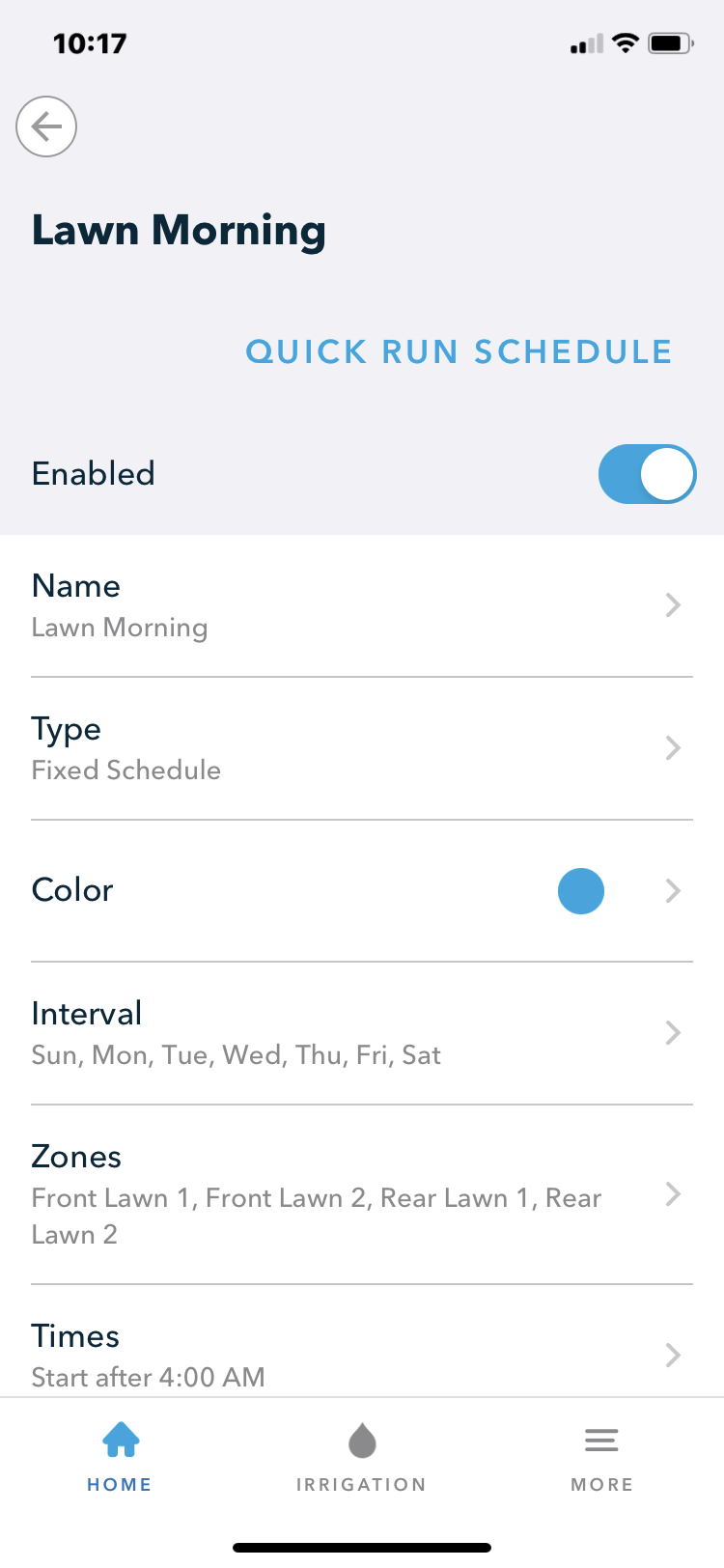

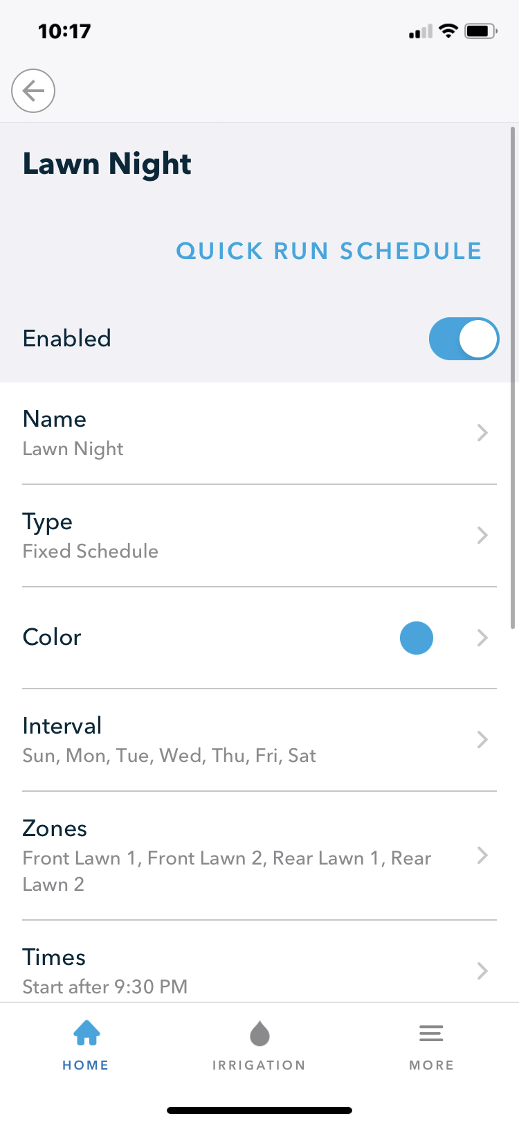

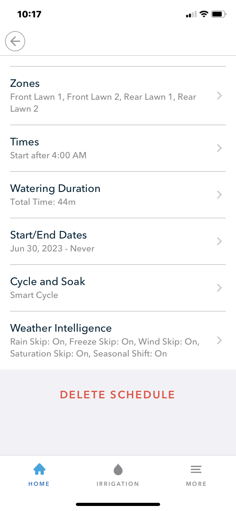

Well, I guess there are a couple questions here…lets start by working on the schedule. Can you post screen shots of your schedule settings? The house is in AZ, but where are you? Obviously, schedule will run based on the location the controller is set to, so you may get notifications that don’t quite line up, just because of time zone differences.

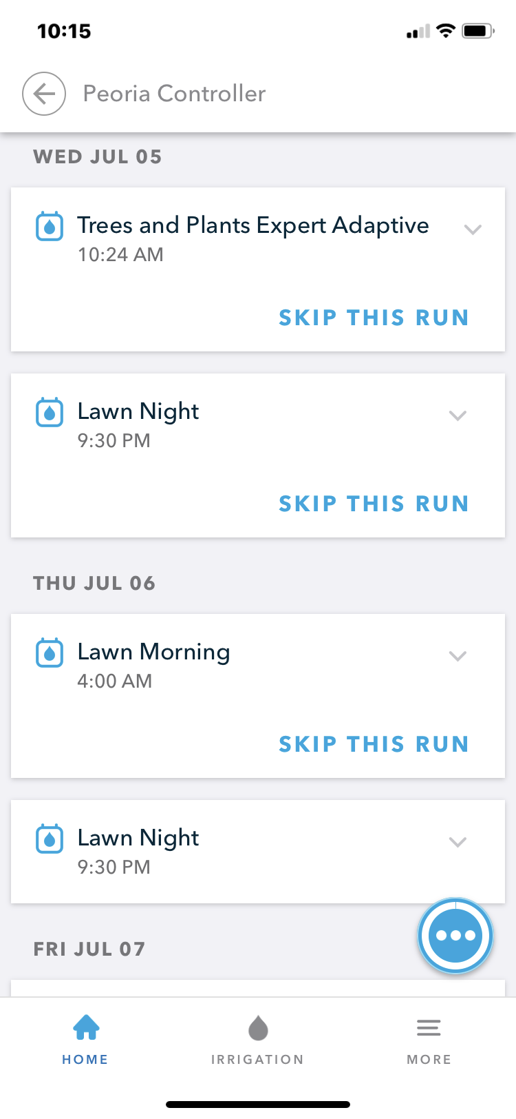

First off, you are getting the notifications at 10:30 because you have your flex daily drip set to end by Sunrise, and the whole drip schedule takes 19 hours to complete, so there might be times that the schedule has to start at about 10:30am the day prior depending on how many zones are scheduled to run. Depending on your zone settings, Flex daily won’t always run all zones the same day. It adjusts as needed. FYI, if using emitter style drip (which is most common in AZ), watering during the day isn’t an issue, in fact can help plants in the heat of the day…
As for the grass, without knowing what kind of sprinklers are there, I struggle to understand how the grass would be dry. You have fixed schedules 7 days a week, watering 11 minutes per zone, TWICE A DAY! Unless your zone settings are WAY off for precipitation rate and you have some very low flow nozzles (like Hunter MP-Rotators), that is a ton of water if those are standard pop up spray nozzles.

I mean, if you have pop up spray heads, they can have a precipitation rate anywhere from 1.5" - over 3"/hr depending on manufacturer and model. So, 11 minutes isn’t horrible, but doing it 7 days a week, TWICE A DAY is A LOT! Your lawn really would benefit from longer watering to get a deeper soak. Chances are you are only wetting the top 2" of soil, while the bermuda roots are sitting at 6", starving for water.

I love Flex Daily. When properly set up, it works very well. But you being remote, and not having daily interactions with how it is looking, plus ( no offence, and correct me if I’m wrong) a limited knowledge of what the zone sprinklers are (manufacture, model, precipitation rate), I’m not sure it would be a good idea to try and switch mid summer. Sounds like the grass is already stressed, and while trying to dial in your settings, I’d hate to see it get worse. The current stress the grass is under I believe is from short, frequent waterings that aren’t getting to the root zone of the grass. You are watering the top surface of the soil, but there isn’t enough water to soak into that root zone. If you deleted the evening run, and made the morning run 22 minutes per zone (maybe more depending on the sprinkler nozzles you have), I think you’d be in a MUCH better situation as a start.

I think the grass just recently got bumped to 2 x a day after comments from the landscaper and sprinkler guy. But I will ask about going longer for the grasses …earlier in the day as well. 1 x. So it goes deeper.
