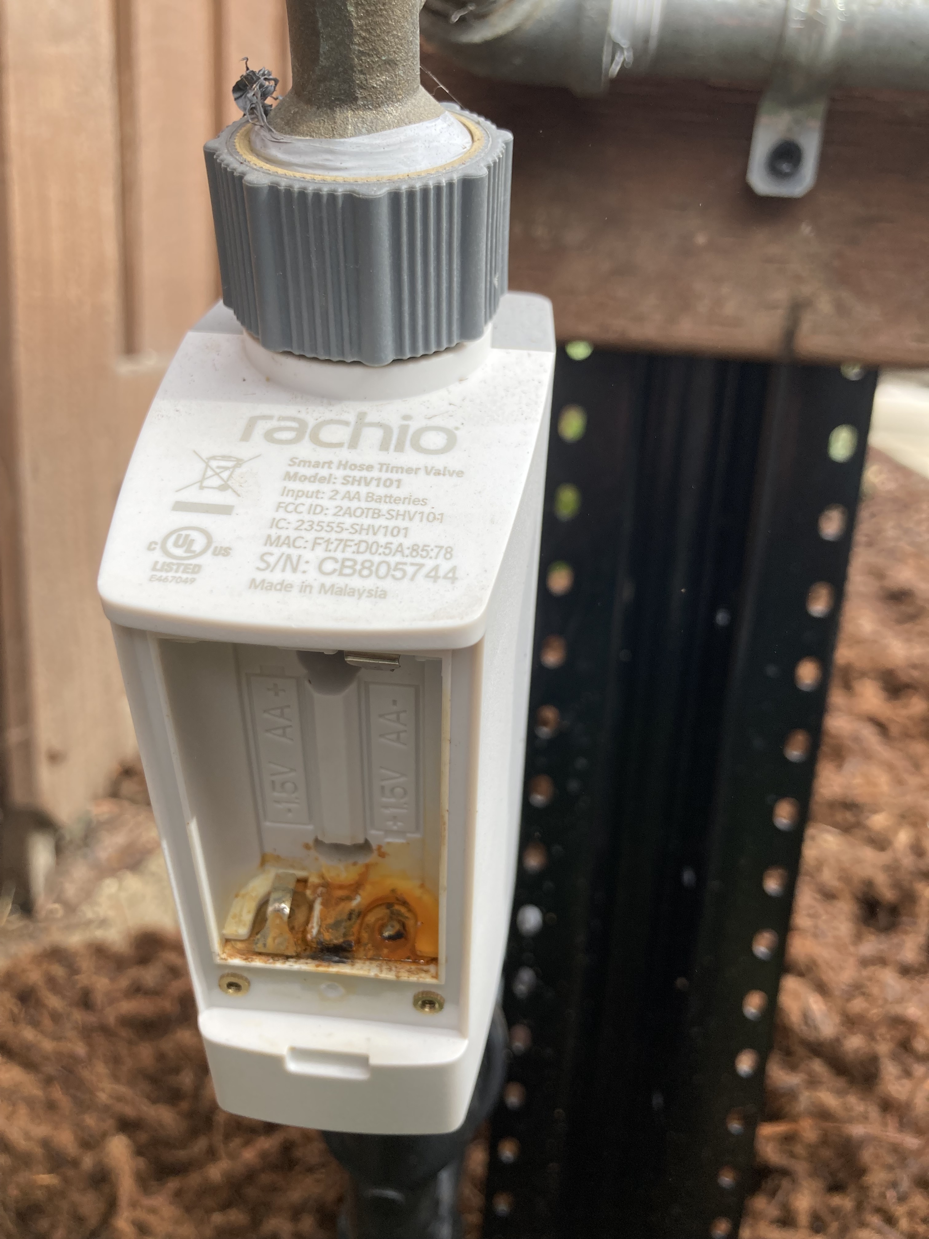

Same here. Twice. First time I thought maybe I could’ve incorrectly installed the battery door. Lots of corrosion inside after 45 days, device quit working. After cleaning thoroughly, I installed fresh batteries and battery door and ensured everything was snug. New batteries completely rusted/corroded within 45 days again, and again device quit working. Obviously this unit’s battery compartment is not waterproof. Frustrating!
Same problem. I’ve only had this device a few months and its already all corroded inside. Doesn’t seem like the waterproofing works well enough :frowning:

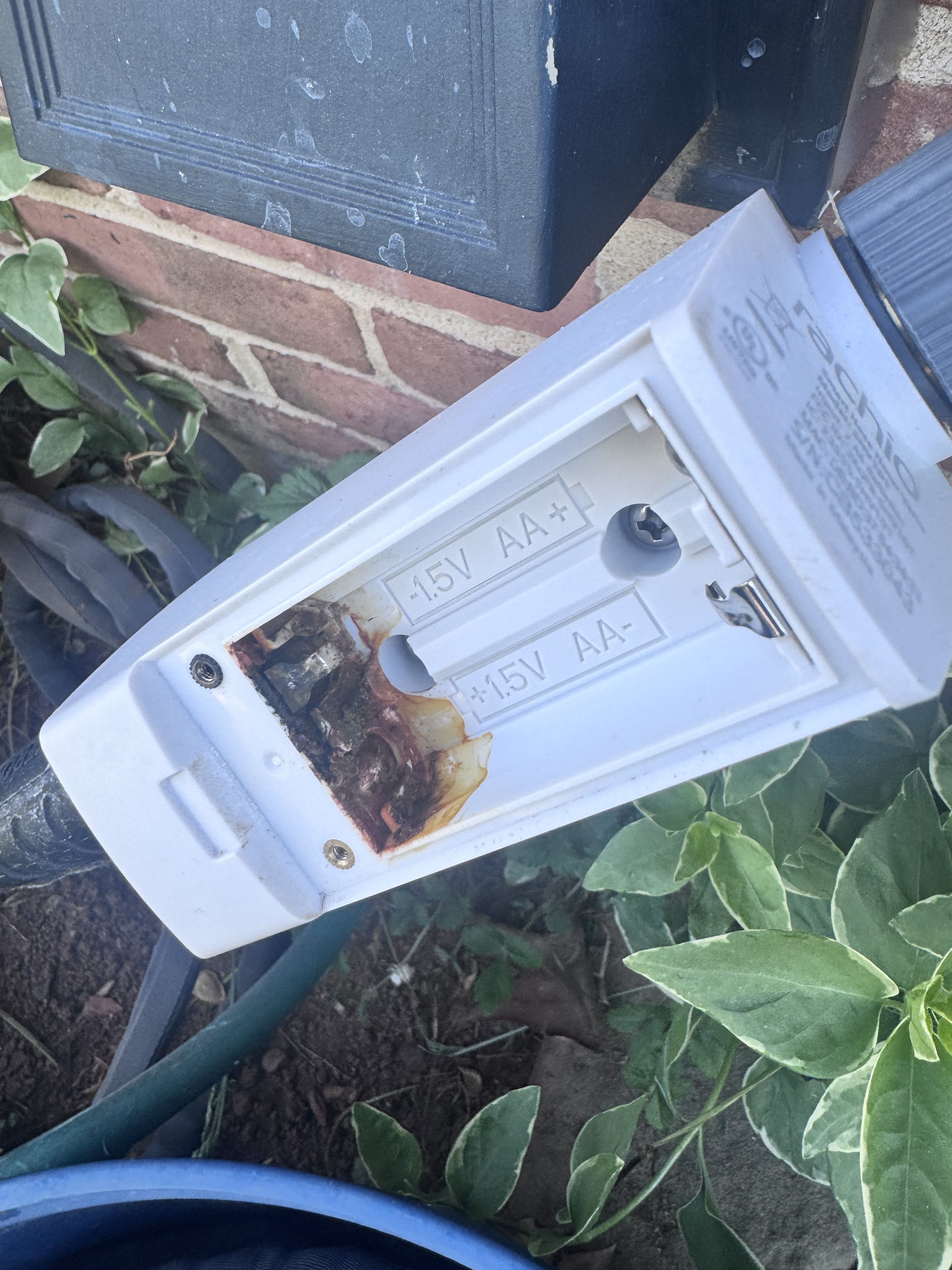

I seem to have a similar problem with the battery compartment. When I went to swap out the batteries the compartment had water inside.
I am quite sure that it was installed properly and I am not subject to freezing temperatures.
Been less than 6 months so did not expect batteries to be expended already… installed in June.

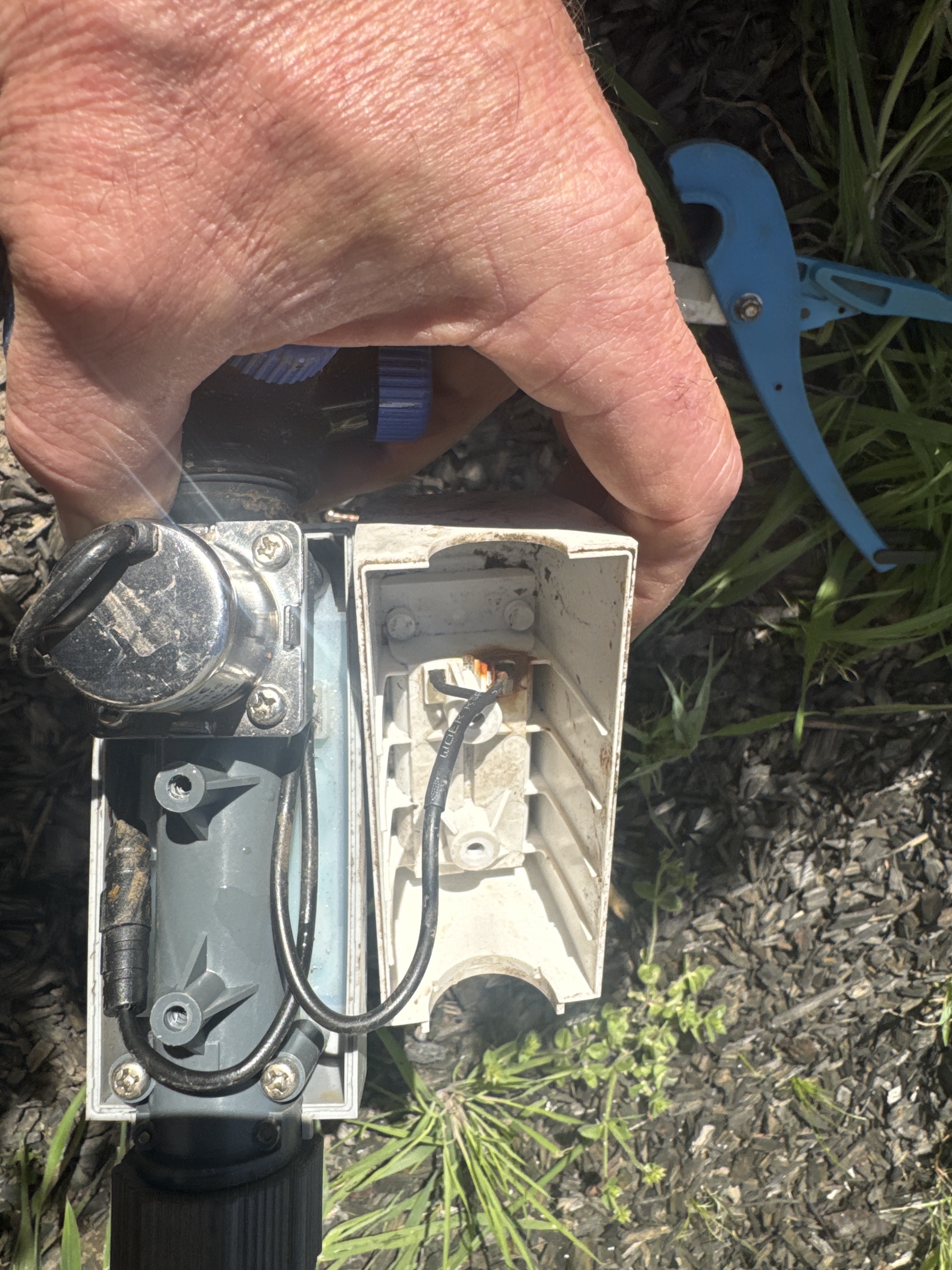

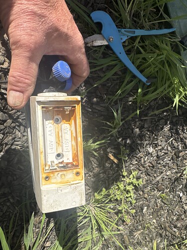

Hi- I too am having the flooding issue. The two valves I’m running were showing as disconnected and I found the flooding when I thought it was a battery issue. I turned out the two screws holding the battery compartment to the valve body. The design is such that the flooding was confined to the battery compartment, and the circuit board and solenoid are sealed. Tried to capture in the photos.
Tried drying out the battery compartment and put the batteries back in - I get a green blink and then a blue and then the LED goes blank and I can’t manually open the valve. Suggestions?

I went back after they had been sitting in the sun for a bit longer and cleaned up the terminals then tried the steps to remove the valves from the app and then add them as new devices and they set up and ran. Maybe replacement battery compartments so the terminals don’t corrode over time, but as I mentioned even though the battery compartment flooded the circuit board and solenoid were well sealed and no water got in beyond the battery compartment.
