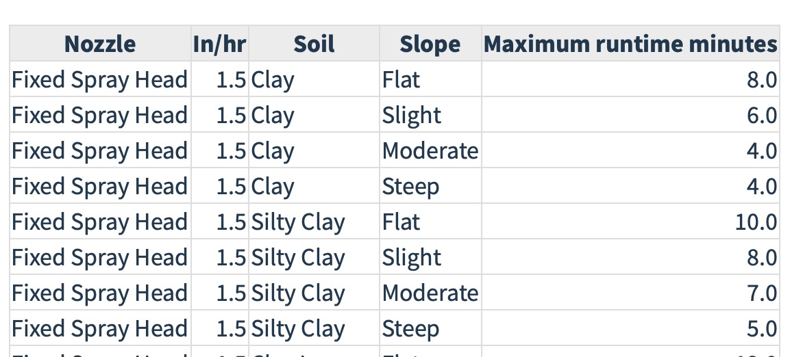

According to this Rachio article the max run-time for Silty Clay soil should be 5, 7, 8, or 10 minutes depending on the slope. Here’s a picture of the relevant section:

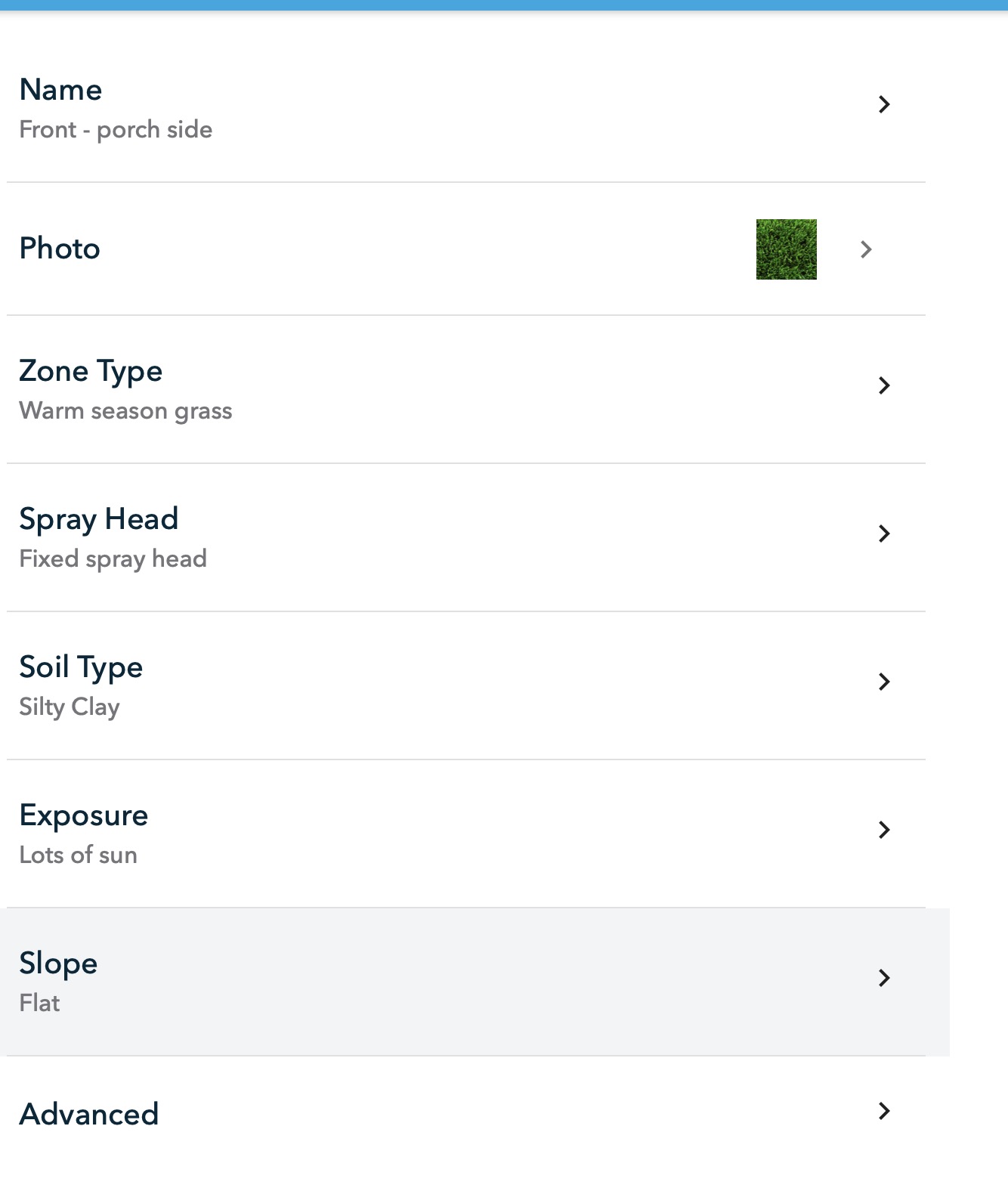

Here are screenshots showing the flat slope setting as an example, this configuration should permit up to 10 minute run times.
Zone setting (NOTE: have made sure ‘advanced’ setting are at default values).

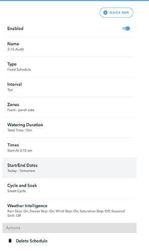

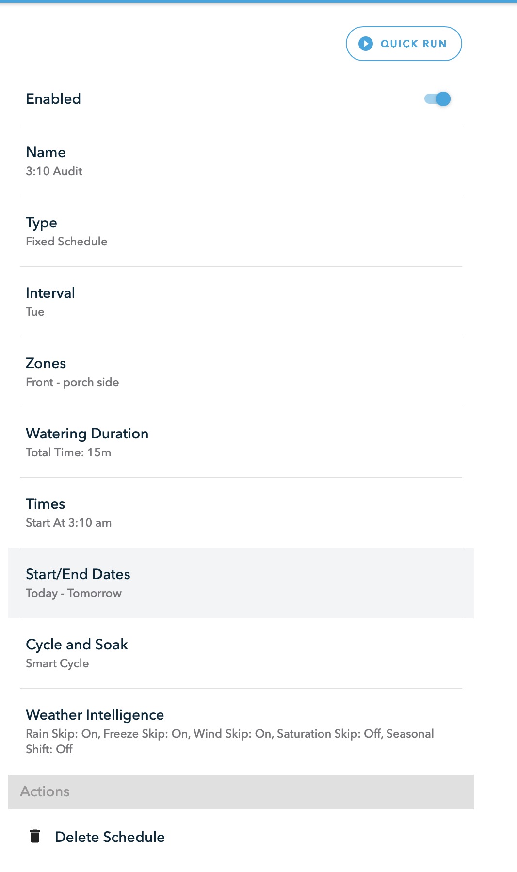

Schedule setting (Smart Cycle enabled):

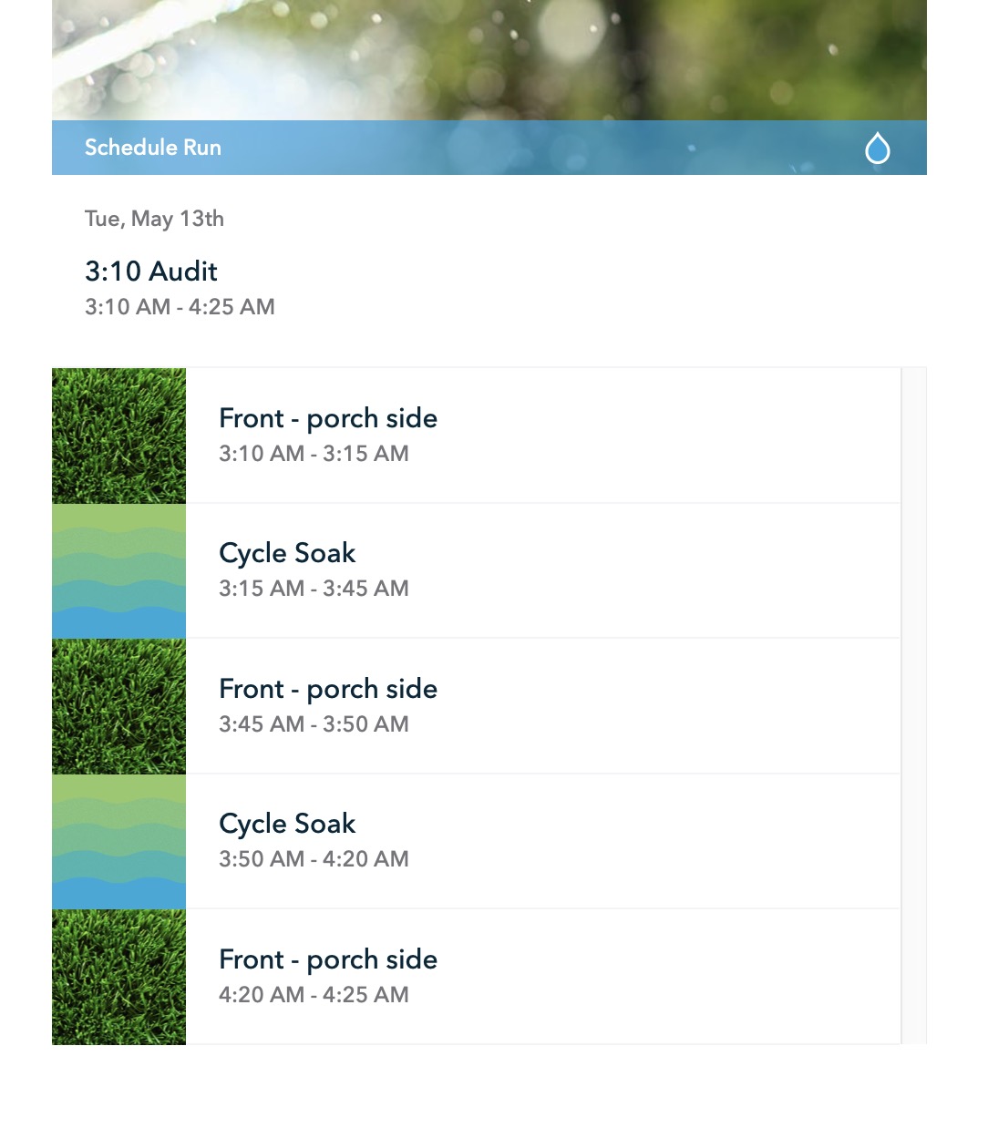

Run time as indicated by Rachio schedule is 5 minutes max:
EDIT: To clarify, this configuration should have a 10 minute maximum run-time, so this 15 minute total duration could have been split into two 7-8 minute cycles instead of three 5 minute cycles.
