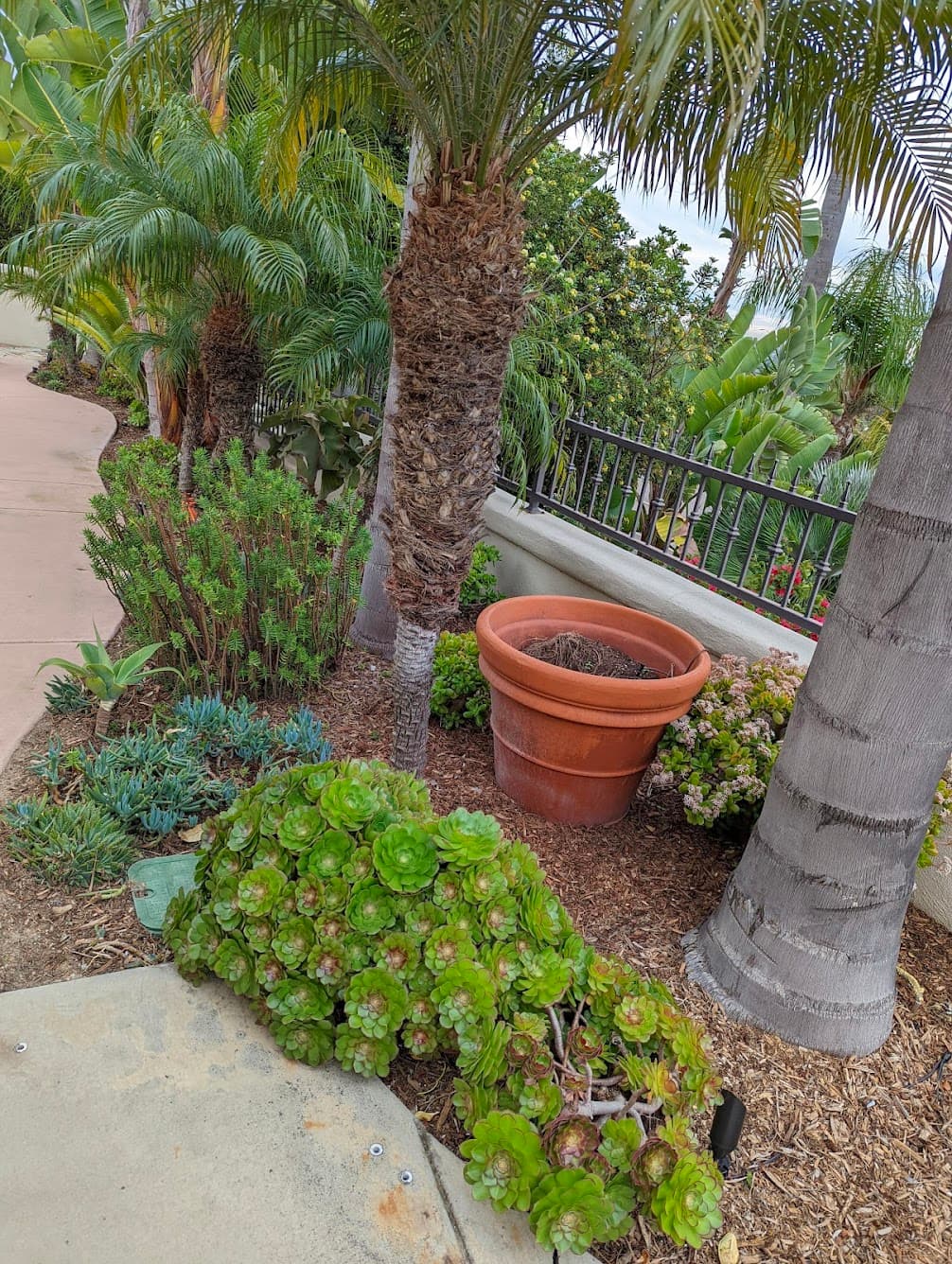

The plants on the zone I showed above are a mix of shrubs and trees. Here’s a picture:
Here are some pictures of other zones I have set to shrub, when it’s mostly a mix of shrubs and trees:

It sounds like the plants were used to shallow watering, especially if it was running every day in the winter. I would decrease the root depth to 12" to start. You even might want to increase the crop coefficient as high as 75% if the trees in the far background are yours too. It’s always a good idea to keep the setting for the wimpiest plants in mixed zones. Shrubs have shallower roots than trees and trees have a higher crop coefficient than shrubs. Eventually, you should be able to slowly increase the root depth over time. I would not go above an 18" root depth, even for established shrubs after 1-3 years of training the roots to grow deeper.
