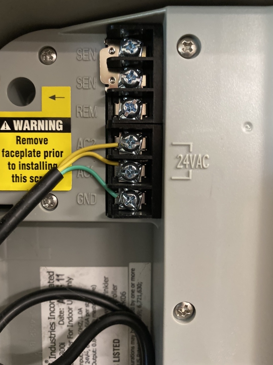

Pics of the two controllers below - first two are one controller, the third is the other. Nothing hooked up to either MV terminal, so no master valve at all. Any obvious issues combining these two systems based on the below?
