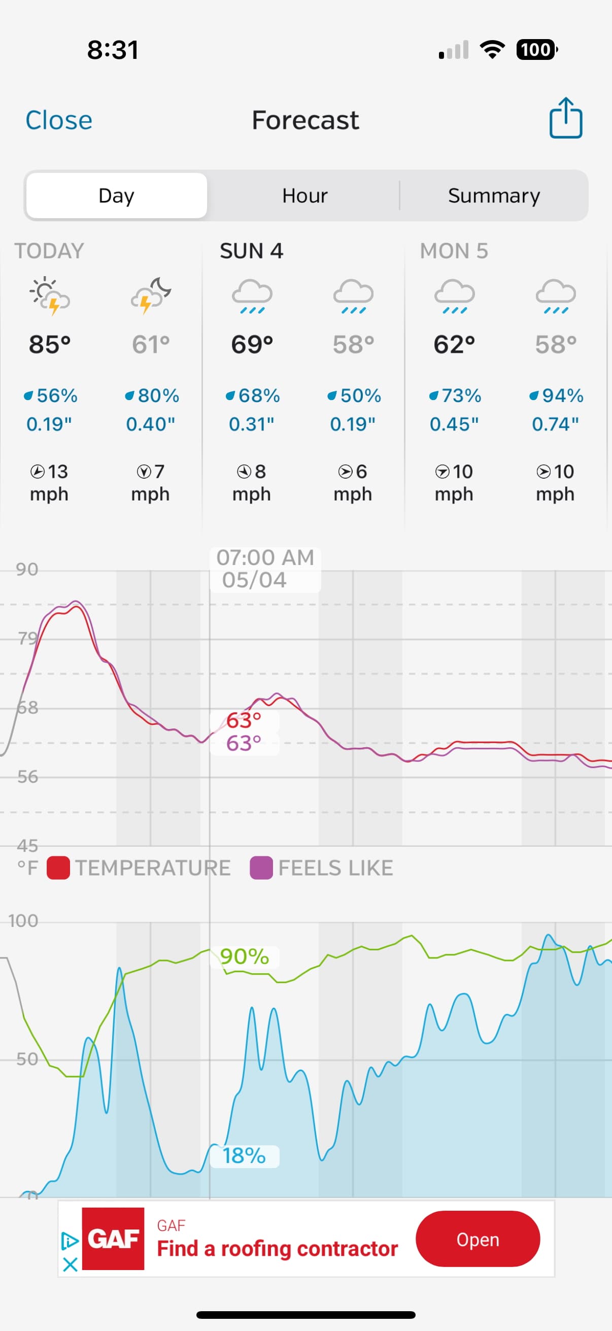

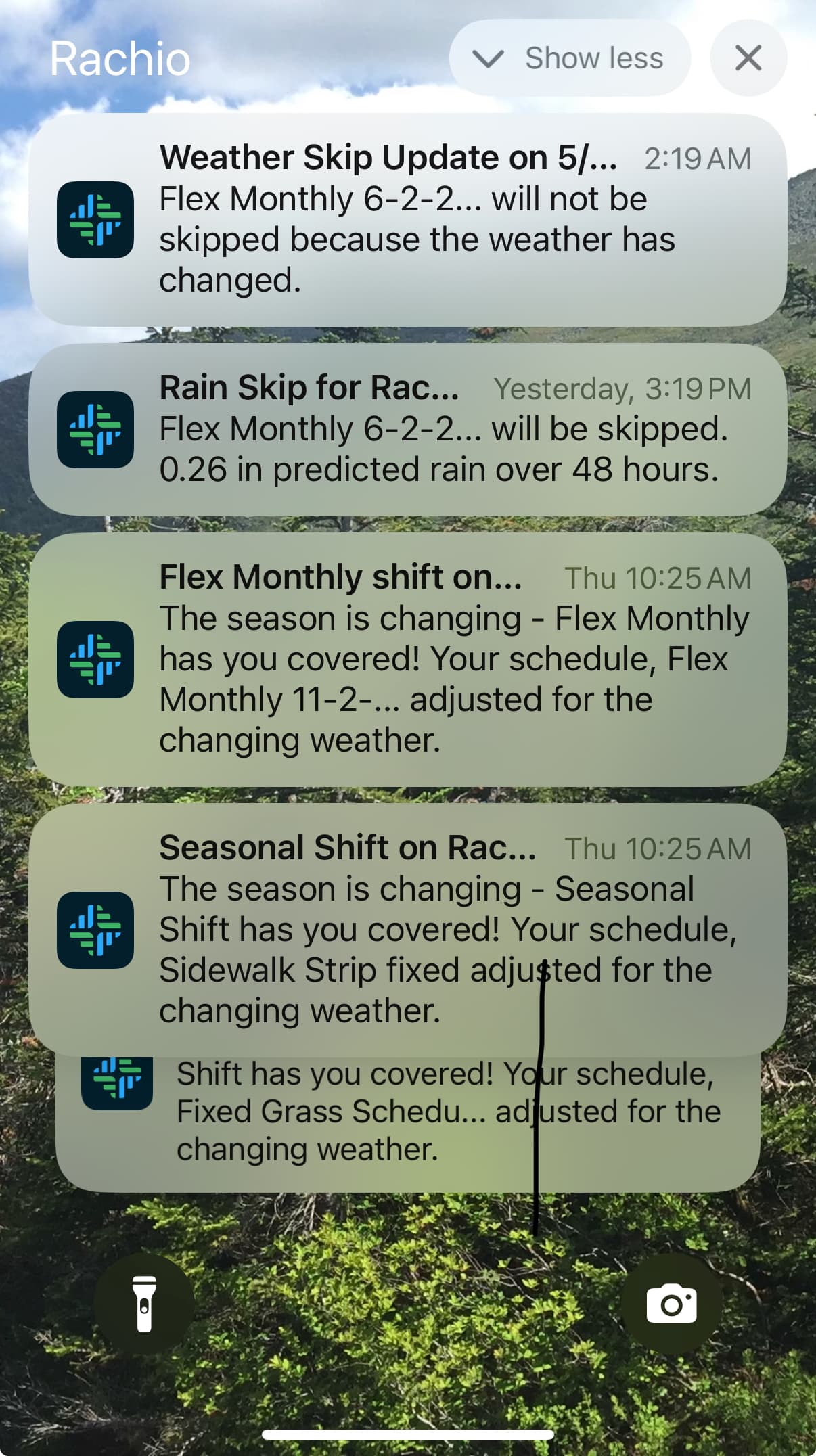

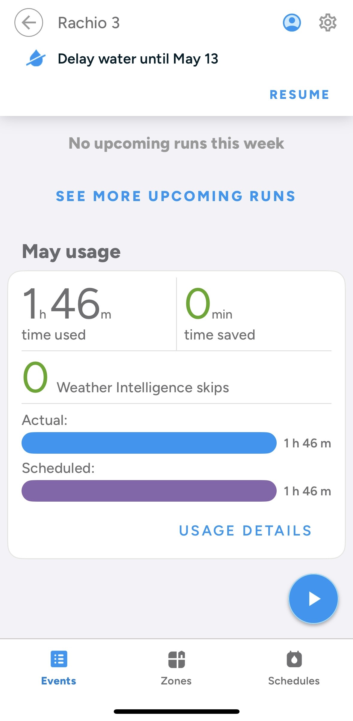

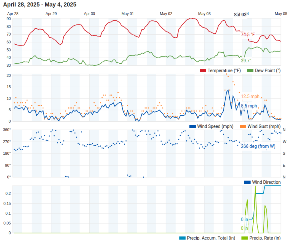

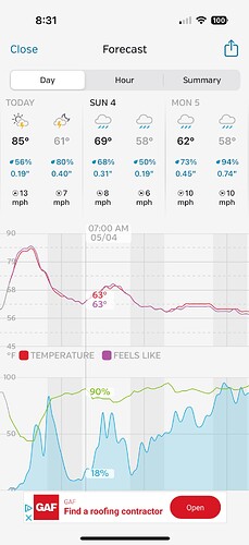

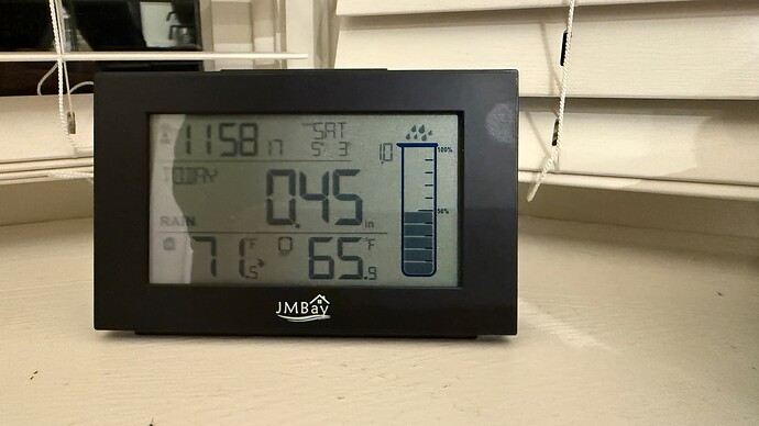

Here is the latest where I was notified by the Rachio app on 5/2/2025 at 3:19 pm that the scheduled watering for the morning of 5/3/2025 would be skipped. In the early morning of 5/3/2025 at 2:19 am, the Rachio app unskipped that same scheduled watering with rains being forecast for the next 3-4 days with total accumulation well over an inch of rain. Attached is the forecast from Wunderground, and screen shots of the Rachio app and the actual rainfall for 5/3/2025 recorded on a a personal rain gauge. At this point I have to believe that the Rachio app and it’s associated logic are broken and can’t be trusted to control my watering schedule. I can see the day coming where I’ll want to have a scheduled watering take place after a week of drought and 80°+ weather and the Rachio app will skip it.
“Flex Monthly 6-2-2024 w/bushes” was the schedule that was used up until today. Today I changed it to a test routine (" Front Lawn Monthly New Lawn Only") which only runs each zone for 1 minute at a 9:00 am. I wasn’t going to have it run for 3 hours at 3:00 am during a rain storm again.
@joeladler1 I had the team review and this is where we can only rely on accurate forecasts that are out of our control. The first forecast was 0.26 inches which you saw, we then query for the forecast one hour before the schedule runs and received a 0.09 inch forecast. We use a third party weather provider for forecasted data.

- The day the system did not skip the forecast precip prediction was 0 inches precip for May 3rd (Saturday). Observed precipitation was zero for the previous days which looks correct. The prediction was clearly wrong since you received .24 inches of precip on that day.

Yeah, in this case forecasted was zero which is concerning, based on that day getting 0.25 inches (by reviewing a PWS close to the controller)
