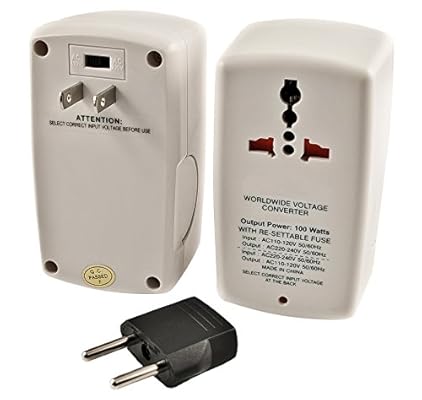

Another option would be to buy a 240V to 120V step down and use the power supply that comes with the Rachio except the step downs cost about $50 from Jaycar.

I used a Transformer with 70 watts rating(240v to 110v) to get this going since original PS is 110v and in Australia we use 240v. It will be a good idea for this company to supply 100-240v ac power supply since it is a global market now. 100 v ac is for Japan.

Same one and this one got 100w load and ideal.
Just FYI 110-240v transformers are a waste of money use a 24VAC transformer like @kimone posted. 110-240v transformers will waste power on the conversion (heat) and cost you more in the long term. A digital device like this has not problems with the 50/60hz difference as it’s timing is digital not analogue.
