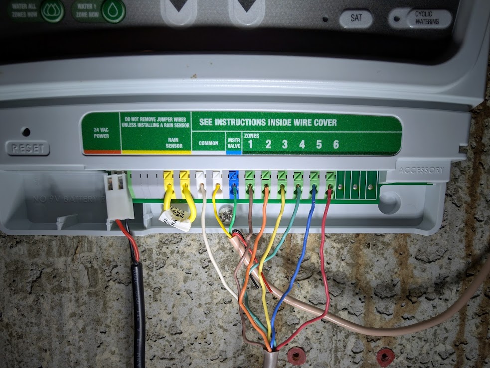

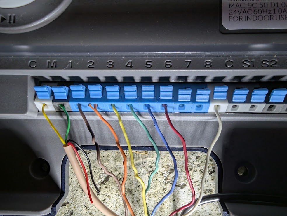

I’ve attached pics of the old and new hookup for reference.

From what I can tell, the wiring looks good. If it is running after the zone is off and you disconnect the white common wire, does the water shut off?
Yes, the water shuts off if I disconnect the white common wire.
