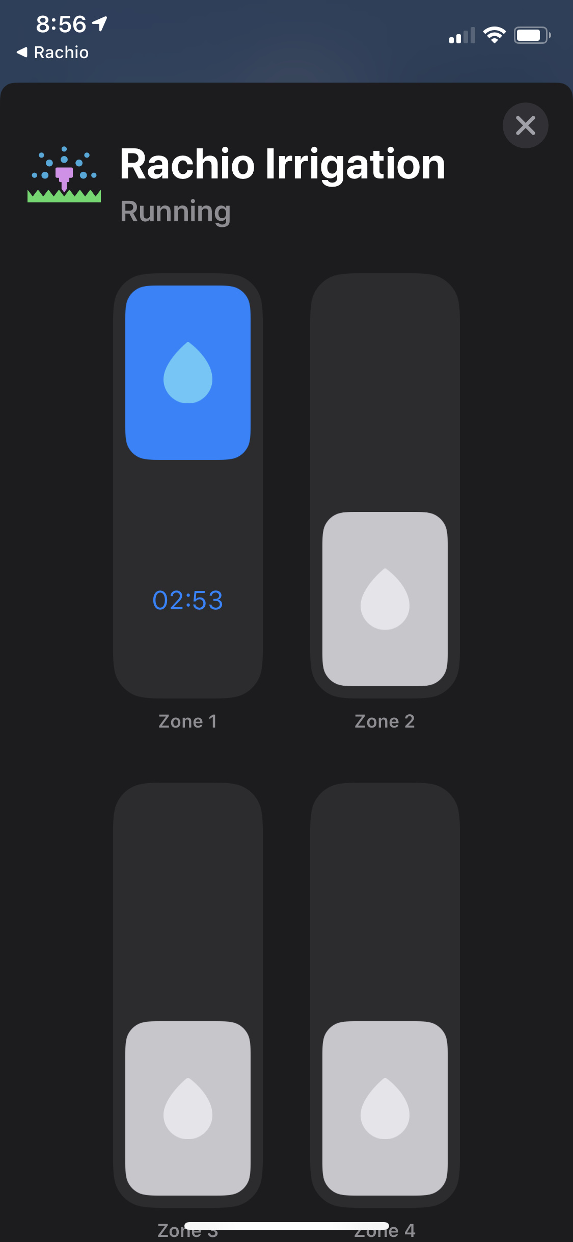

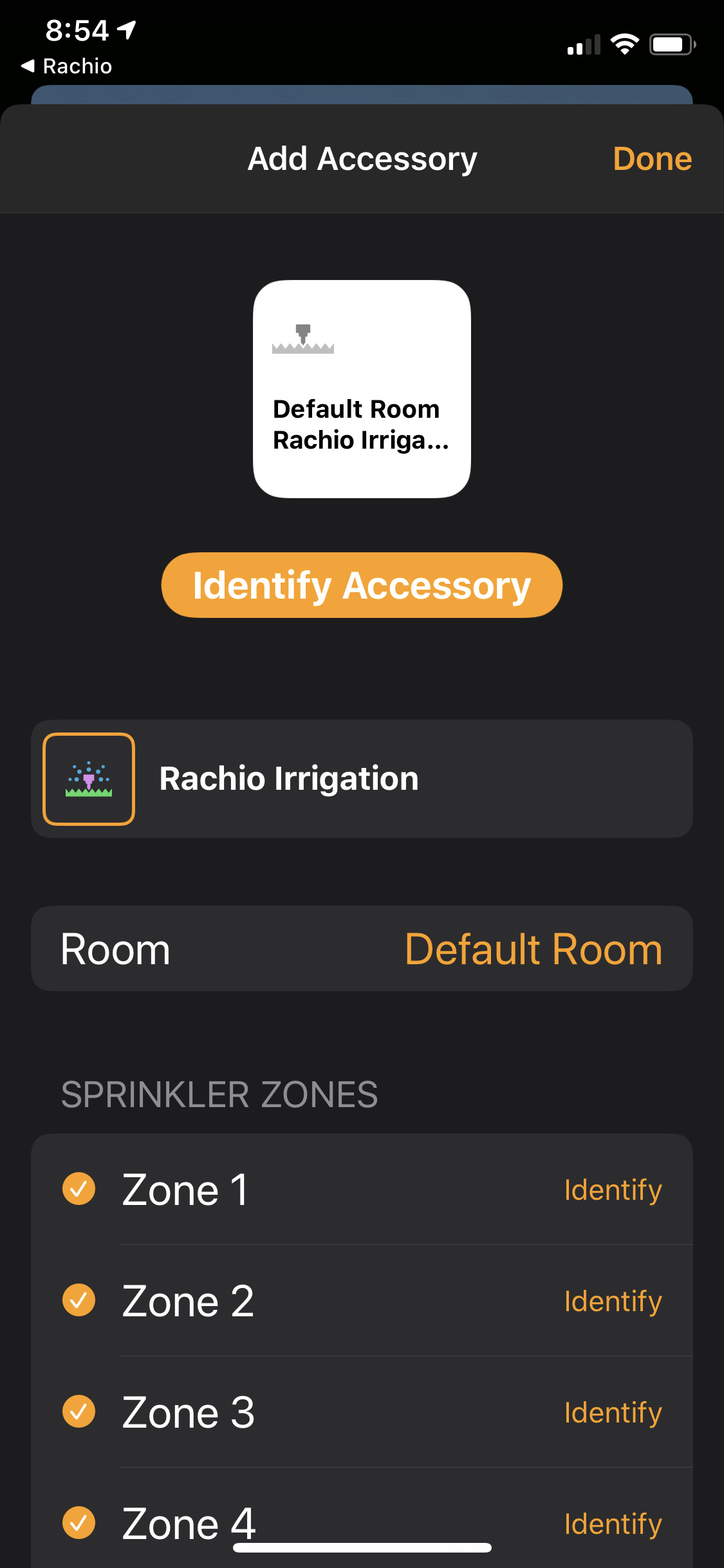

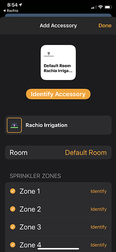

I was immediately able to add the Rachio controller to HomeKit on the 615 firmware. First try. No issues.

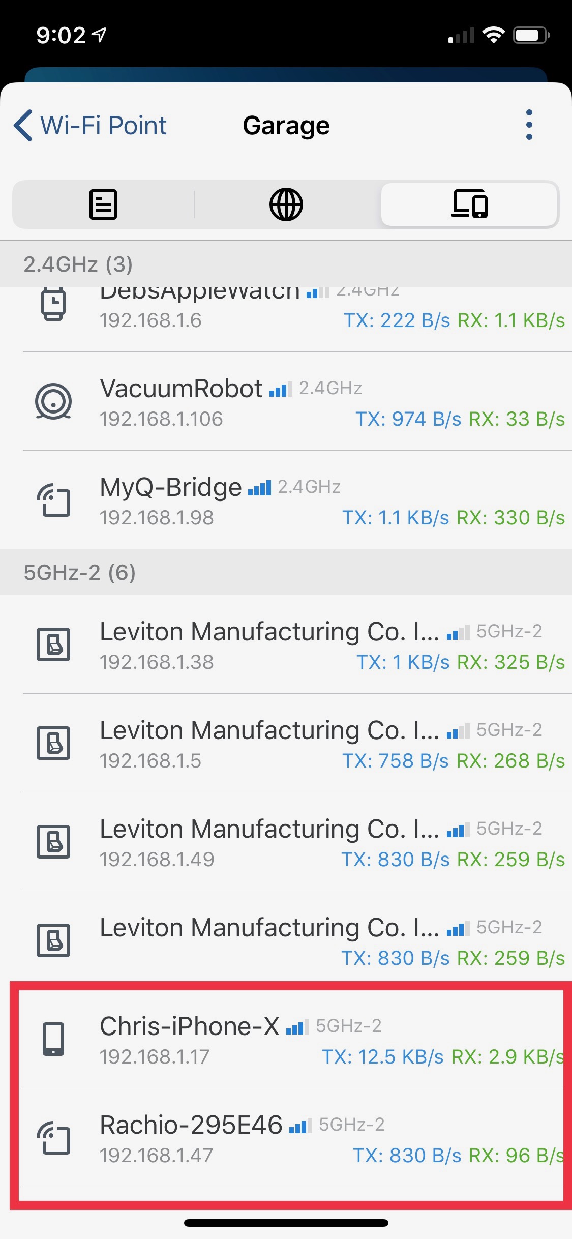

This is with a Synology mesh router network (2 nodes). The Rachio on 2.4 GHz and my iPhone on 5 GHz -when- I added Rachio to HomeKit…
*FYI - After setup, I noticed the Rachio moved to 5 GHz Automatically.

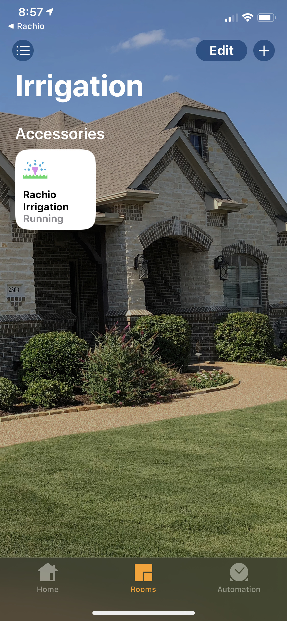

Thanks to Franz, my Rachio 3 has been reverted back to 615. I was able to add it back into the Home app immediately on my first try. I didn’t have to do any “special” at all.
I look forward to this being fixed on future firmware updates and am still willing to beta test any new releases specifically aimed at HomeKit fixes — for now though, 615 works great as it always had.

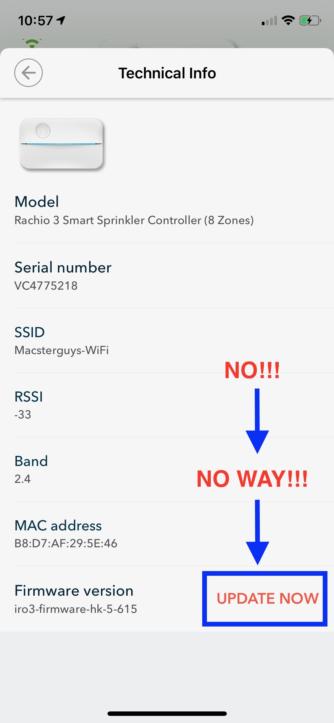

NOW THIS HAPPENS UPDATE AVAILABLE
Now my controller says a update is available??? NO WAY!!!
• What version is trying to install, 632?
• Are these updates automatic? (no way)
• Will this update automatically install? (NO WAY)

I can confirm that reverting back to firmware version 615 also allowed me to re add the Rachio 3 Controller to HomeKit! Thank you @franz and @Macsterguy!
I can also confirm that downgrading to 615 allowed me to re-add the controller to HomeKit and control it as I could before. I did have to reboot it at least once and fiddle with my WiFi a bit but it showed up instantly when I did.
