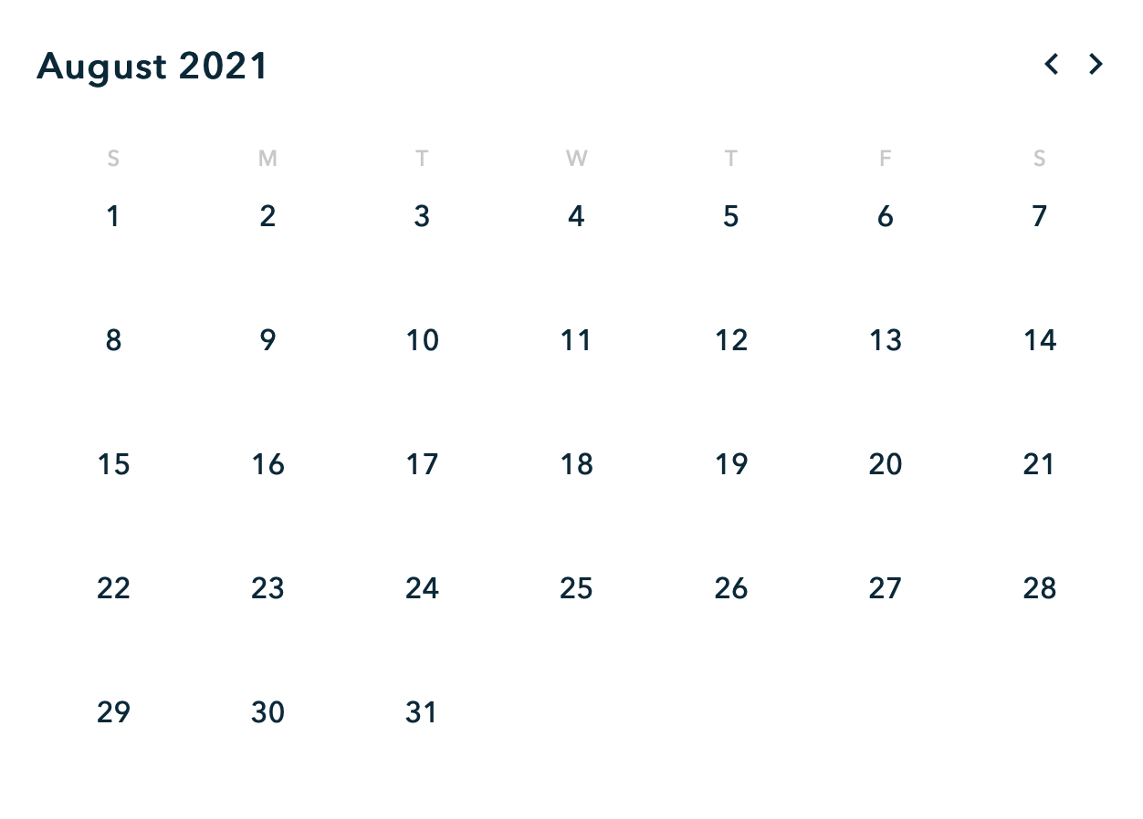

I just set up a Rachio 3 system here in Sweden (Europe). Technically it works fine, it controls my Hunter valve kits feeding my Hunter 0.4gph driplines. However when I set up the Zones (using a partially shaded Bamboo hedge as my example here) it recommends 3min only (!) watering, scheduled to never occur… It doesn’t matter which smart schedule I set, I always get 3mm and looking at the calendar - no watering, ever.
I have no clue what’s wrong here. There are weather sensors in the area, I adjusted the advanced flow rate to match my 0.4gph 12" spacing surface drip emitter line (Hunter) in the Advanced settings, but apart from that it is all pretty standard.
