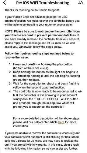

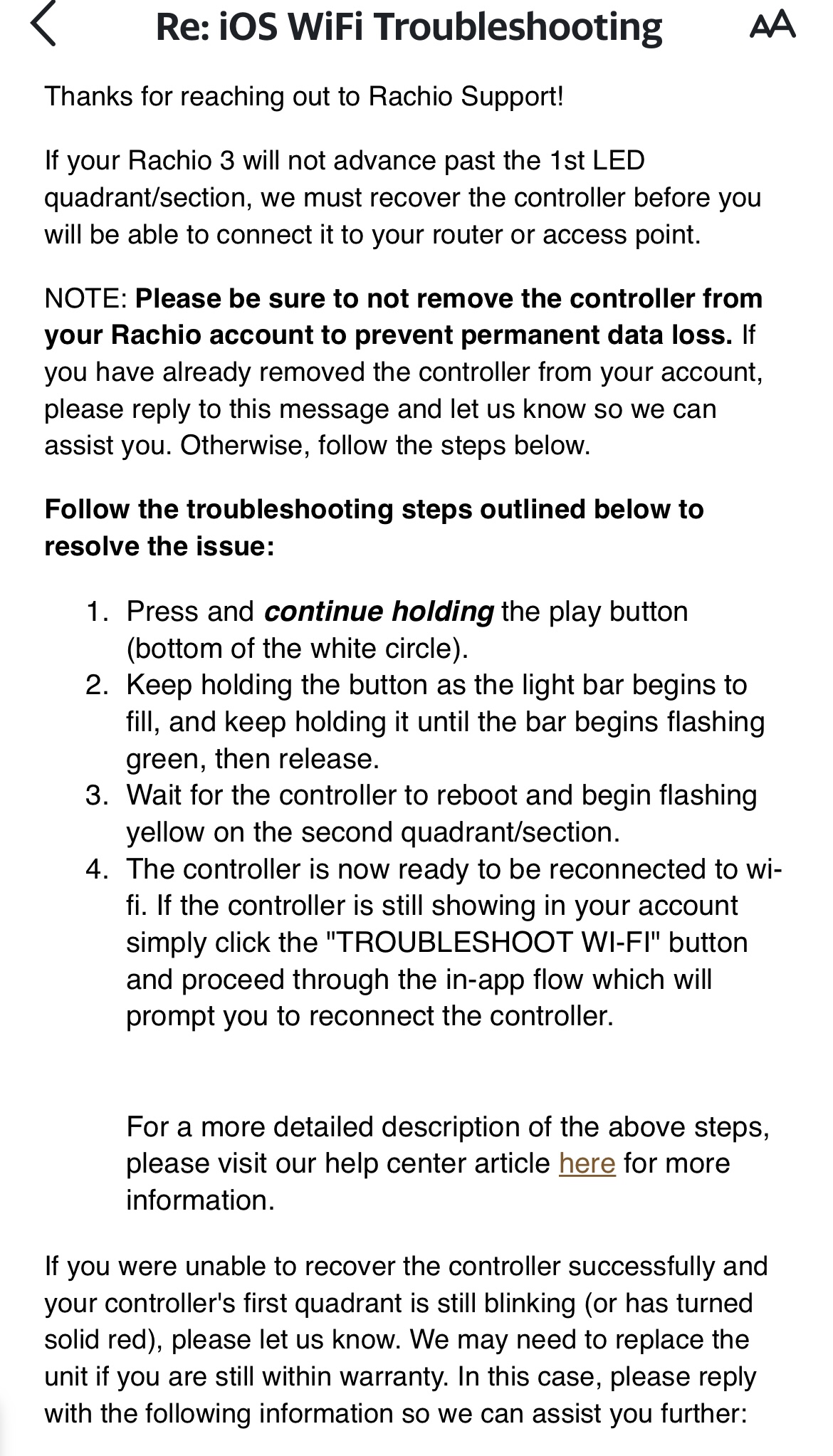

Is the sequence you are seeing 9 white blinks followed by a red blink in the first quadrant only? Have you followed this guide to reconnect to wifi?

Followed the above Rachio technicians email instructions: But Failed ! Tried to push the STOP button after unplugging the power to reset the unit : failed
