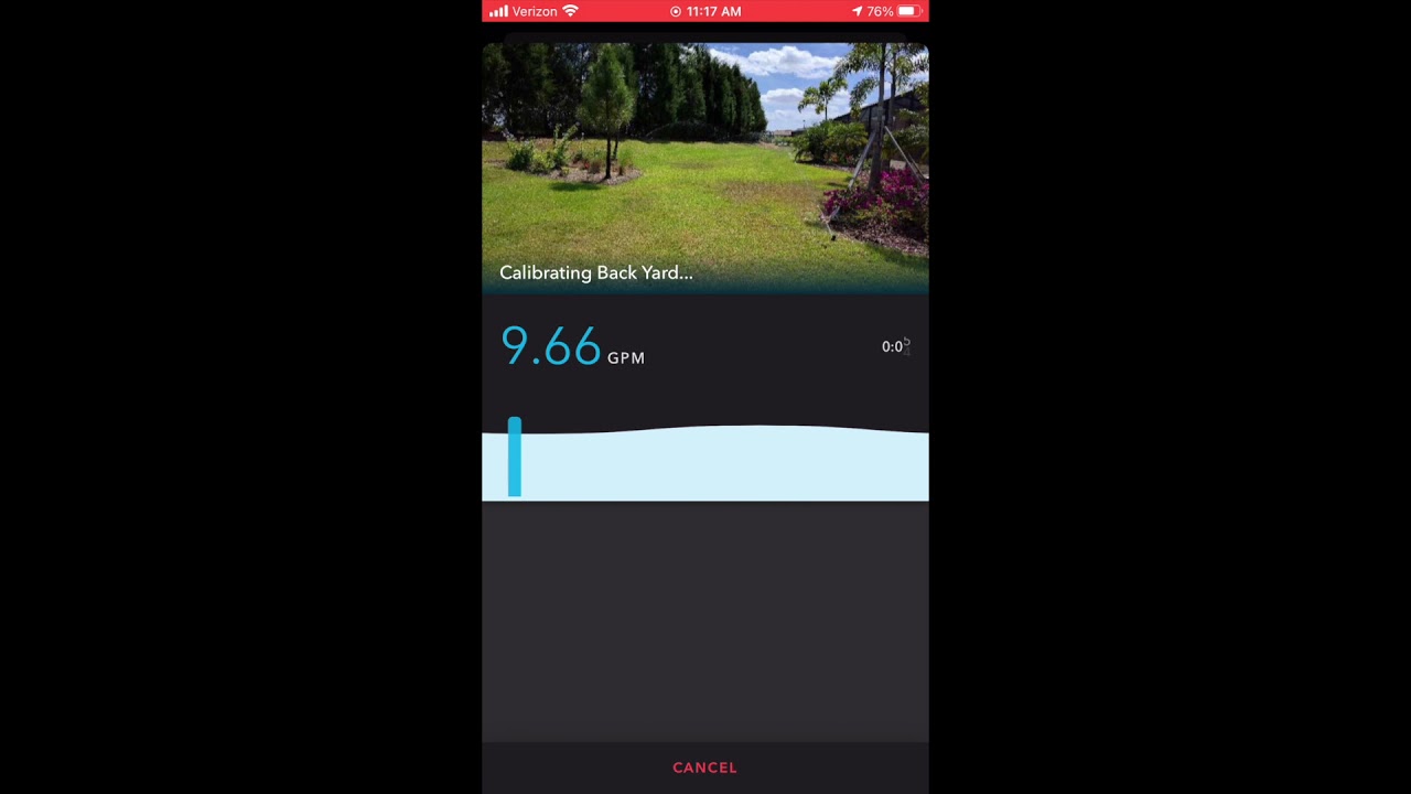

I went back today to re-calibrate the zones and while the calibration process runs- it indicates 0 flow. When I hit cancel, it shows the flow. (Pictures attached)
Is this a program bug in the apple app?
Somewhat related… I have the rachio wireless flow meter and it only shows the first bar of the calibration graph and then doesn’t update until the calibration period ends. Not sure when that started but I used to be able to watch it stream in GPM data in real time during the calibration session. Bug in the calibration routine @franz?
Here’s a video so you can see what I’m seeing. Rachio reports flow GPM in the first 15 seconds of calibration, which is always wrong because the system is still pressurizing, and then I don’t get another reading until calibration is complete.
The final calibration value appears accurate but it would be nice if the GPM bar chart filled out as calibration was happening like it used to.

I’m experiencing this exact same issue. I’ve been a Rachio user for years. We just got a brand new system installed and I upgraded to the Rachio 3 with the Everydrop 1004-EX. When I’m calibrating, it only shows the first flow point and not the rest of the calibration points in order to create the average. In years past when I used to have the Rachio Wireless sensor, this was not the case. I agree there is a bug in the calibration routine.

Thanks for flagging this folks! To make sure I understand this, the end calibration result is correct, but the smooth line graph animation that demonstrated the real-time readings to get the average is no longer appearing?

Good news! An update was pushed out to correct this issue. Please update to version 4.4.6 and report back here if you have any further issues.
