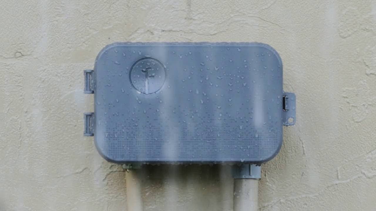

I just bought an enclosure on Amazon thinking that it came with the plug wiring as some people have said and also some additional hardware to install that way and it didn’t. Any idea what I should buy to do this? My understanding is it was also supposed to come with something to secure the plug wiring like a nut or something. I got all this from an install video I watched from googling it. Am I missing something else?
Did you buy a random enclosure, or did you buy the Rachio brand enclosure?
The rachio enclosure for both version 2 and 3
And what are you saying that it is missing? The box itself is designed to be hard wired, and has a plug for the Rachio controller to be plugged in to. Being that ever installation is different, I don’t believe that they include anything for installation, other than maybe some mounting hardware…

FWIW, I just received my enclosure (ordered from HomeDepot). It comes with the plug/pigtail already inside - seen here:
Thanks. I was talking about the part that would wire into that and plug into the wall to provide the box power.
Oh I see, sorry I misunderstood. I was under the impression that the wiring coming IN to the box should be from a hardwired source (ie not a plug to an outlet that is external to the Rachio enclosure).
That is what they recommend but in their install video they have the alternative install as well.
