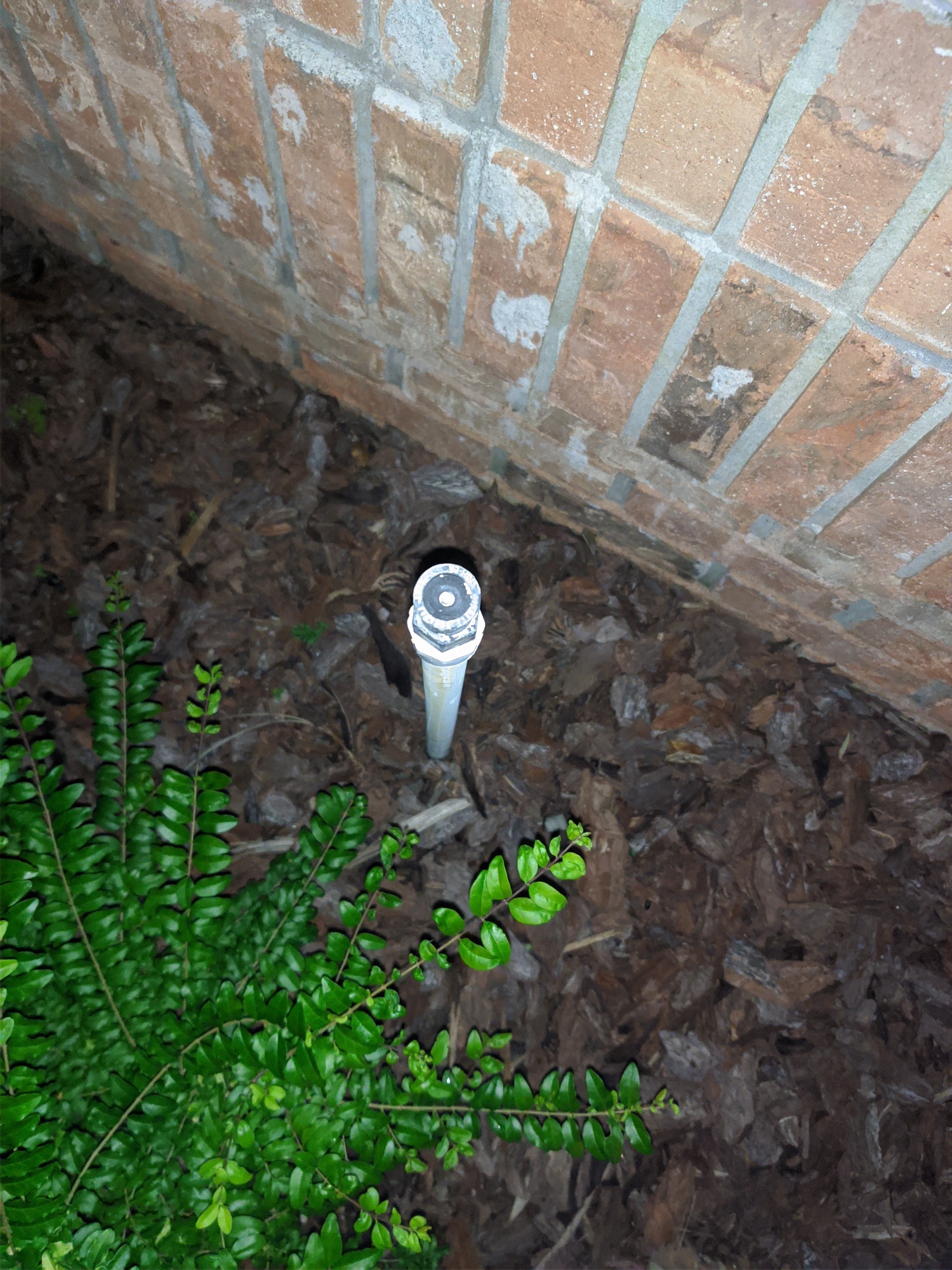

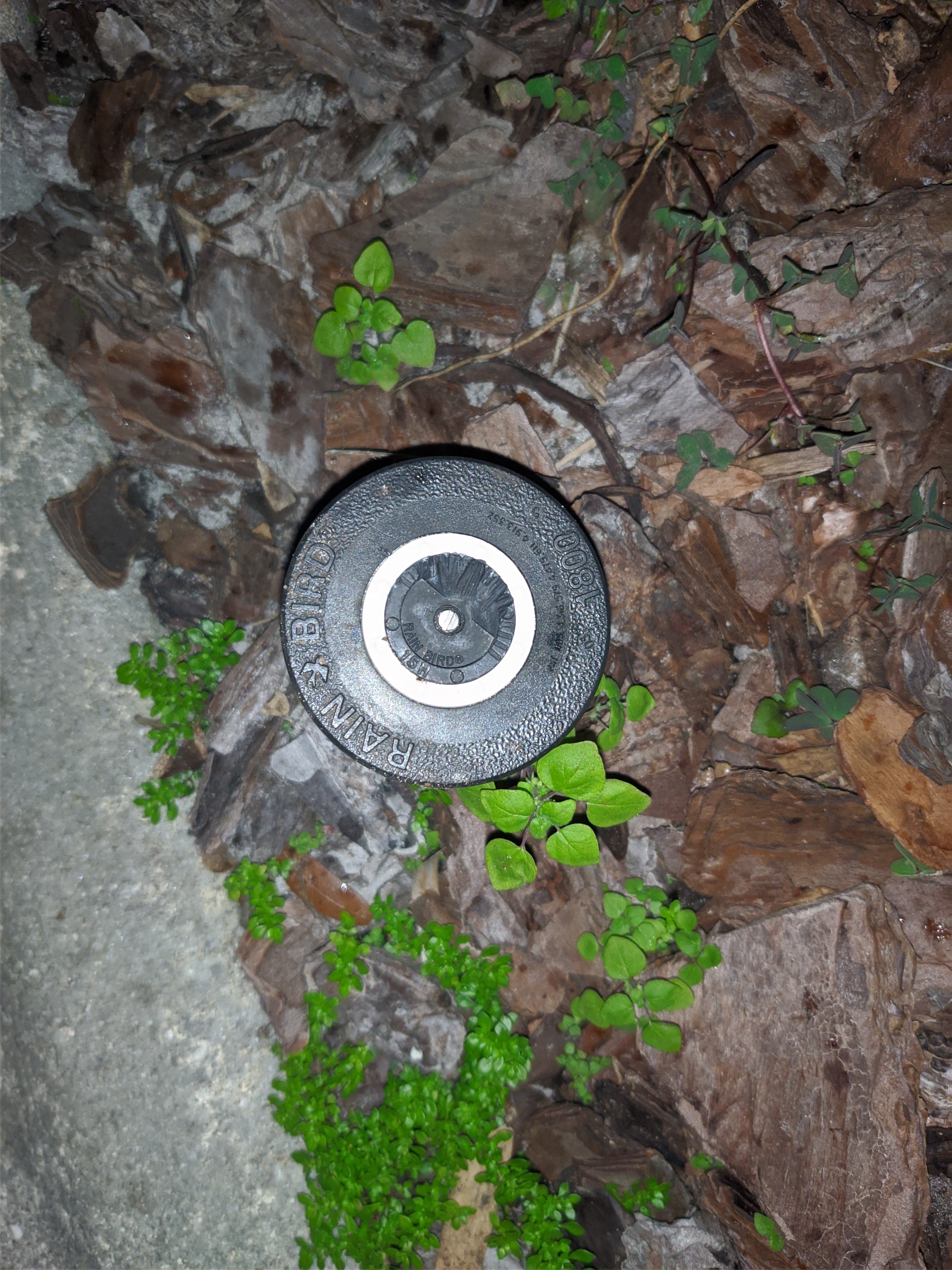

I am in Florida and have St. Augustine grass. I also have plants, tress and bushes that are inside the zones.
There are some settings I have to play around with, ex: zone 6 has a few rotating nozzles.
