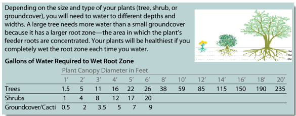

You can use the Web Soil Survey site to look up your address and would tell you what the native soil is. It is usually pretty accurate, however with large subdivisions, they do a lot of earthwork to the lots prior to building, so use it as a rule of thumb. What you found from AI might be somewhat accurate since it probably pulls from the WSS site…
Not sure what your shrubs look like, but I usually set mine to put down about 4 gallons. My biggest “shrubs” I have stepped up to a 2gph to give them a little extra if it looks like the 4 gallons (which works on 90% of my shrubs) isn’t cutting it.

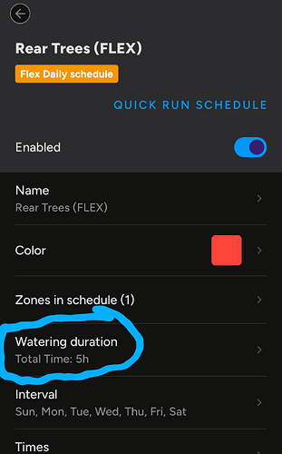

Here’s what I ended up with in Rachio after setting up soil. It’s .84 inches in the app, which breaks down to .32 PR? Hopefully that makes sense. It appears the run time is 1 hour 40 minutes per zone.
Seems like it might be pretty good. You have double the GPH of mine, but half the time…

In the spreadsheet I fill out that I have 2 gph emitter, I want 4 gallons of water per plant, and the inches of water applied from the Rachio application which is .84. The spreadsheet output is now saying my custom nozzle PR is .42. So the spreadsheet is basically reverse engineering the soil types and the Rachio .5 nozzle inches to determine how to put down 4 gallons per plant?

Yes. Once you enter the “Inches of Water applied in Flex Daily schedule” value from Rachio (found in your “moisture levels” under irrigation), and the estimated gallons (from the water use it wisely chart), and the emitter output GPH (add together total output if multipler emitters per plant), the calculation in column H will be what you want to enter for inches per hour in the zone settings.

You can also check your run time to be sure it’s what you expect. Look in the schedule attached to that zone.
