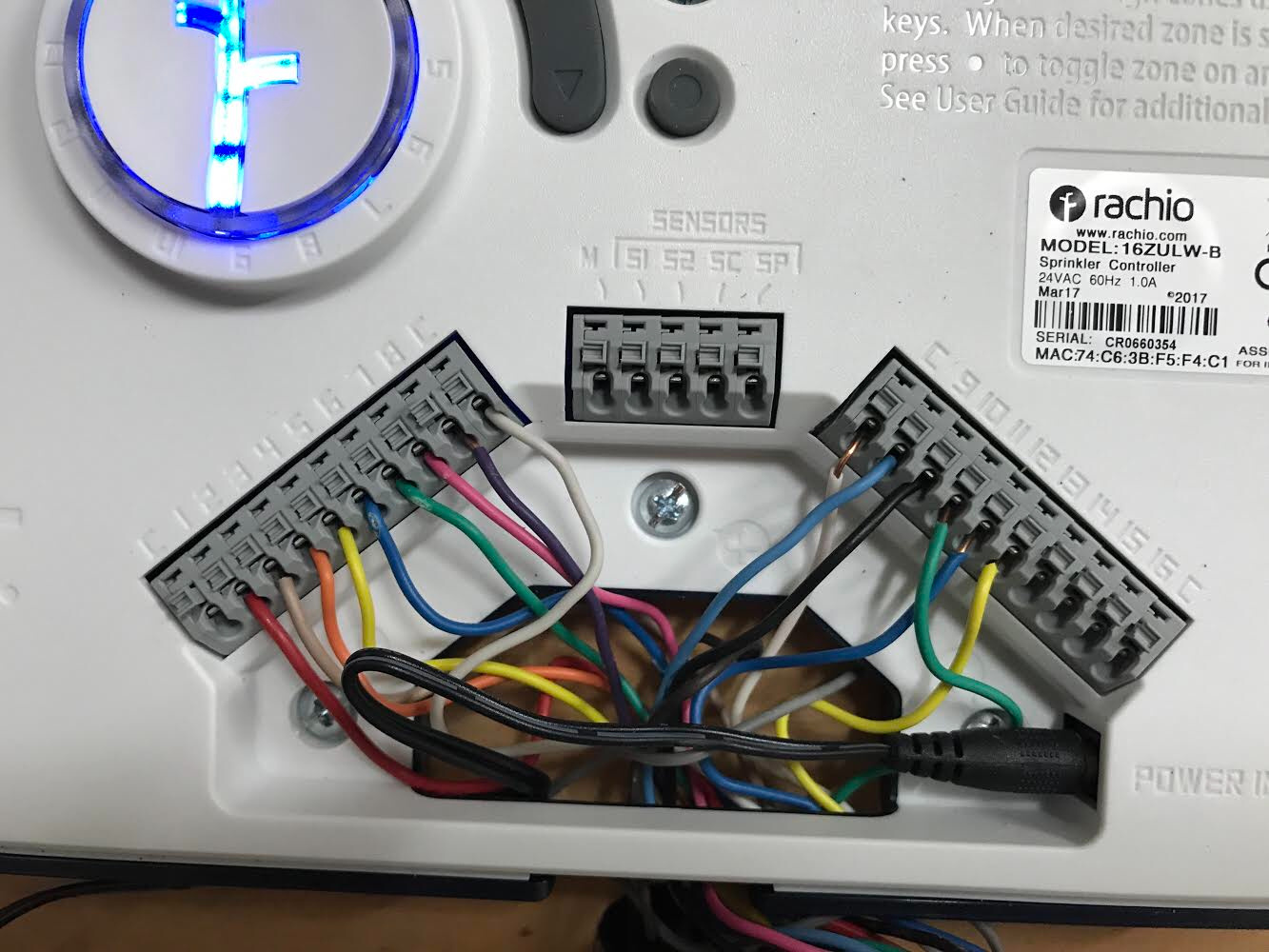

Do you have any photos of your old wiring, or how the Rachio controller was wired? Did you test the RainBird before installing the Rachio controller? After reviewing all of the current values your zones reported, everything looks very standard except for zones 5, 6, and 11-16 reporting no current. The controller only provides 24VAC to the terminals, so I am not sure if that could short the wires.
Rainbird was in use for two years working completely fine prior to Rachio install. At initial Rachio install, all zones were working fine (did not have zones for 14-16, so should not have been reporting anything but 5-6 and 11-13 worked fine).
@jeffreytneal - the wiring looks correct from the two photos. Here are my thoughts on a couple of things to try:
If you have a volt meter, you can test the voltage coming out one of the zones to see if current is coming from the Rachio. Set the range to handle 24 volts and to test AC, not DC. Then put one probe in one (any one it doesn’t matter) of the C(ommon) ports and then the other probe into the zone that should be running.
Go to a valve box and manually turn on the valve and see if the system kick in.
Use the buttons on the Rachio to manually run a zone. As there appears to be two field wires, I’d choose one zone from each group to test.
I’m wondering if there is something with the sprinkler boost pump not coming on.
I agree wholeheartedly with @DLane on this. Manually turning on the valves will help determine if its a water issue, pressing the buttons on the Rachio itself will help determine if it is a connection/app issue. Please keep us updated!
