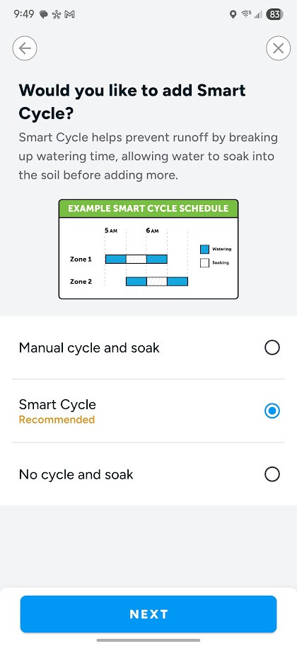

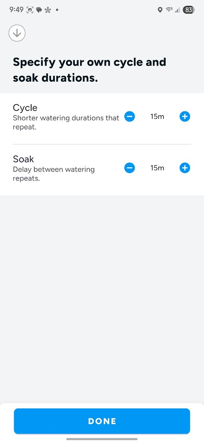

I believe what they meant was setting up a schedule and using the “manual cycle and soak” feature. From there, you can set how long you want it to run, and how long to soak. You’ll probably need to create a new schedule to access this as I don’t think you can change this on an existing schedule.
