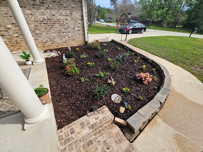

I just saw your reply (not sure why I wasn’t emailed). We definitely have a leak in one of the pipes, the water just puddles and runs under the sidewalk. We just planted all that landscaping and mulch. I hate to dig it all up to find the leaking pipe. At the time of planting, I thought the system was done, due to the demo in our backyard.

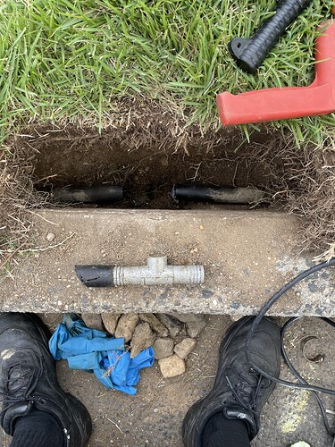

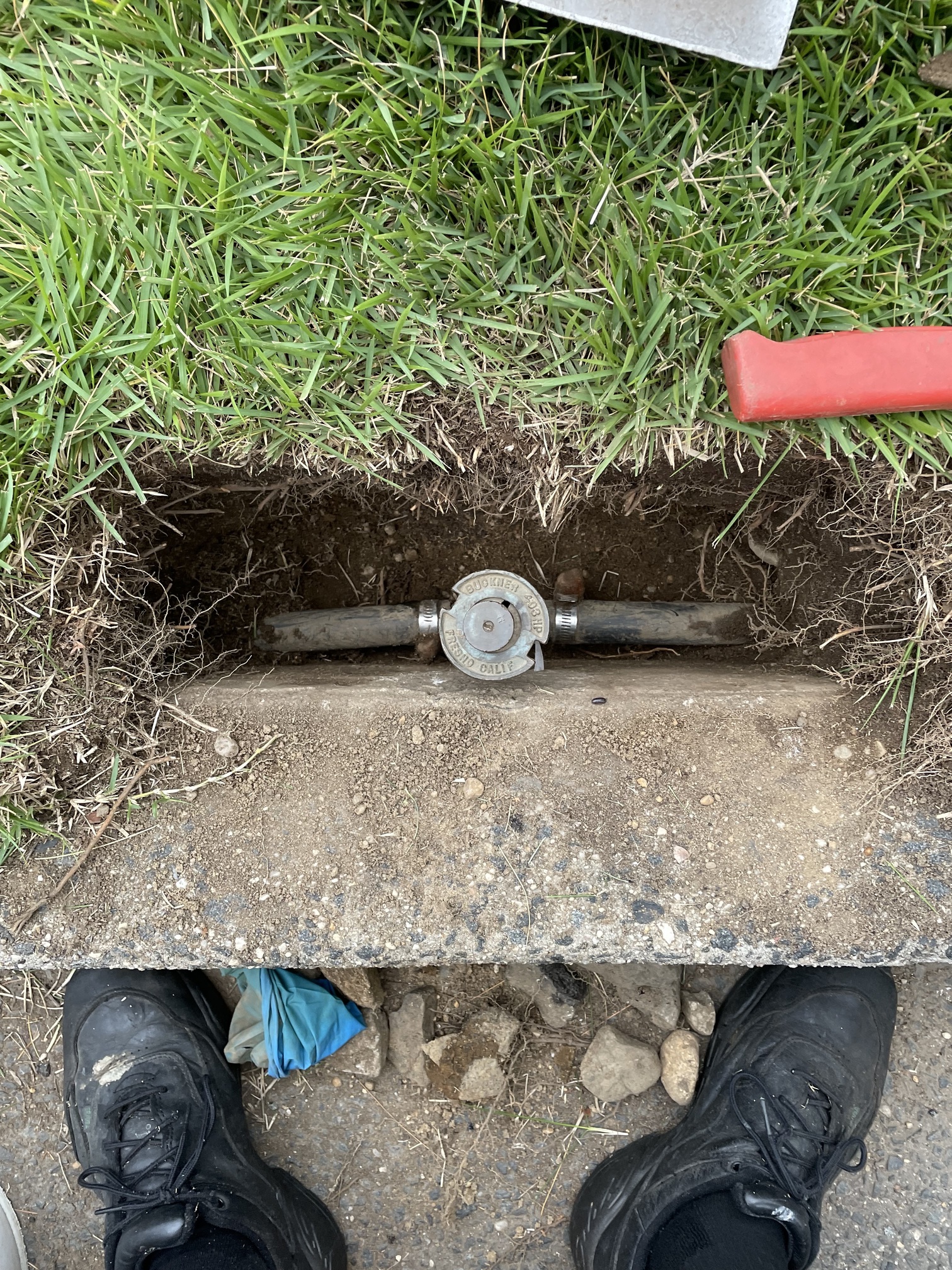

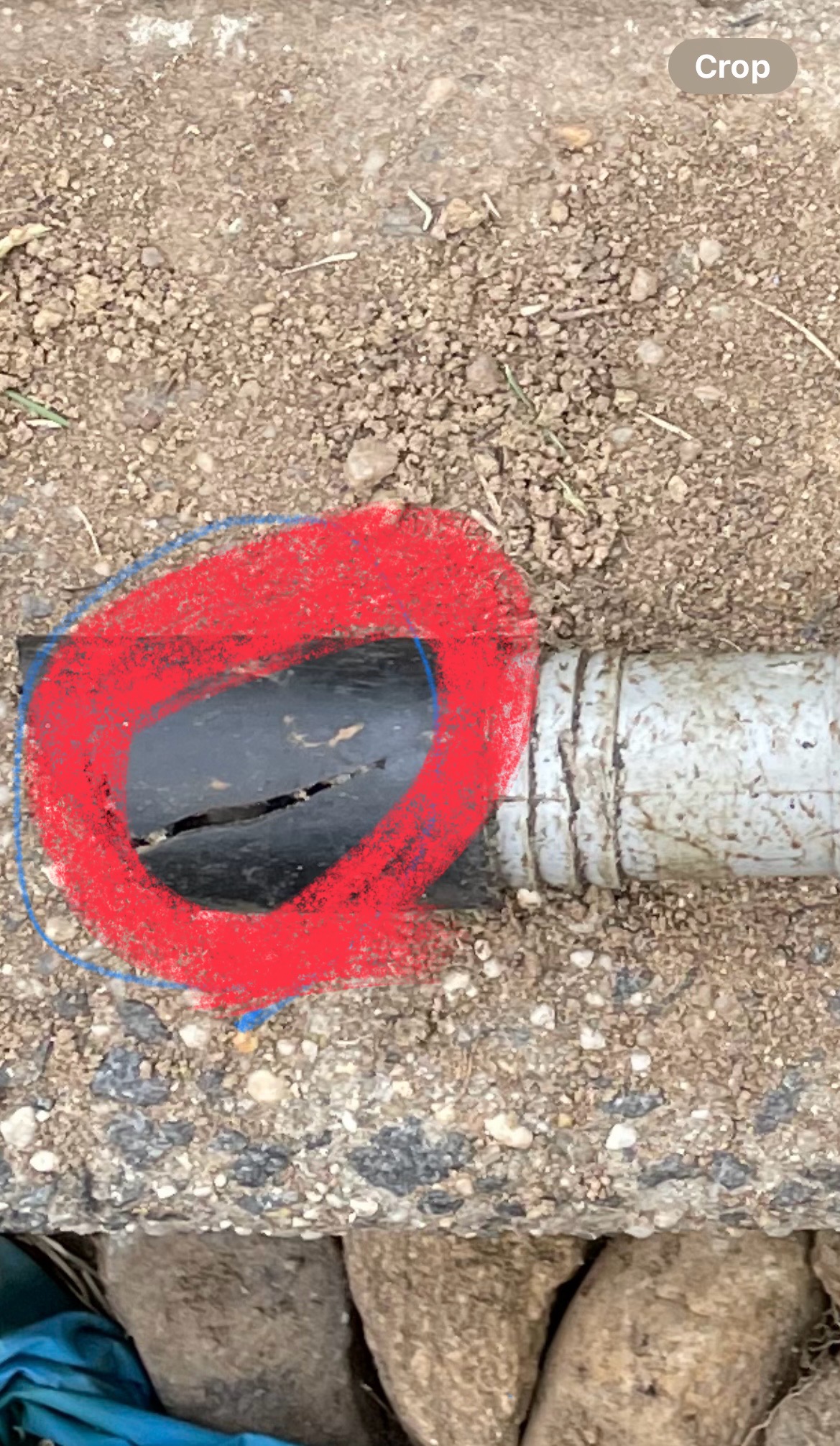

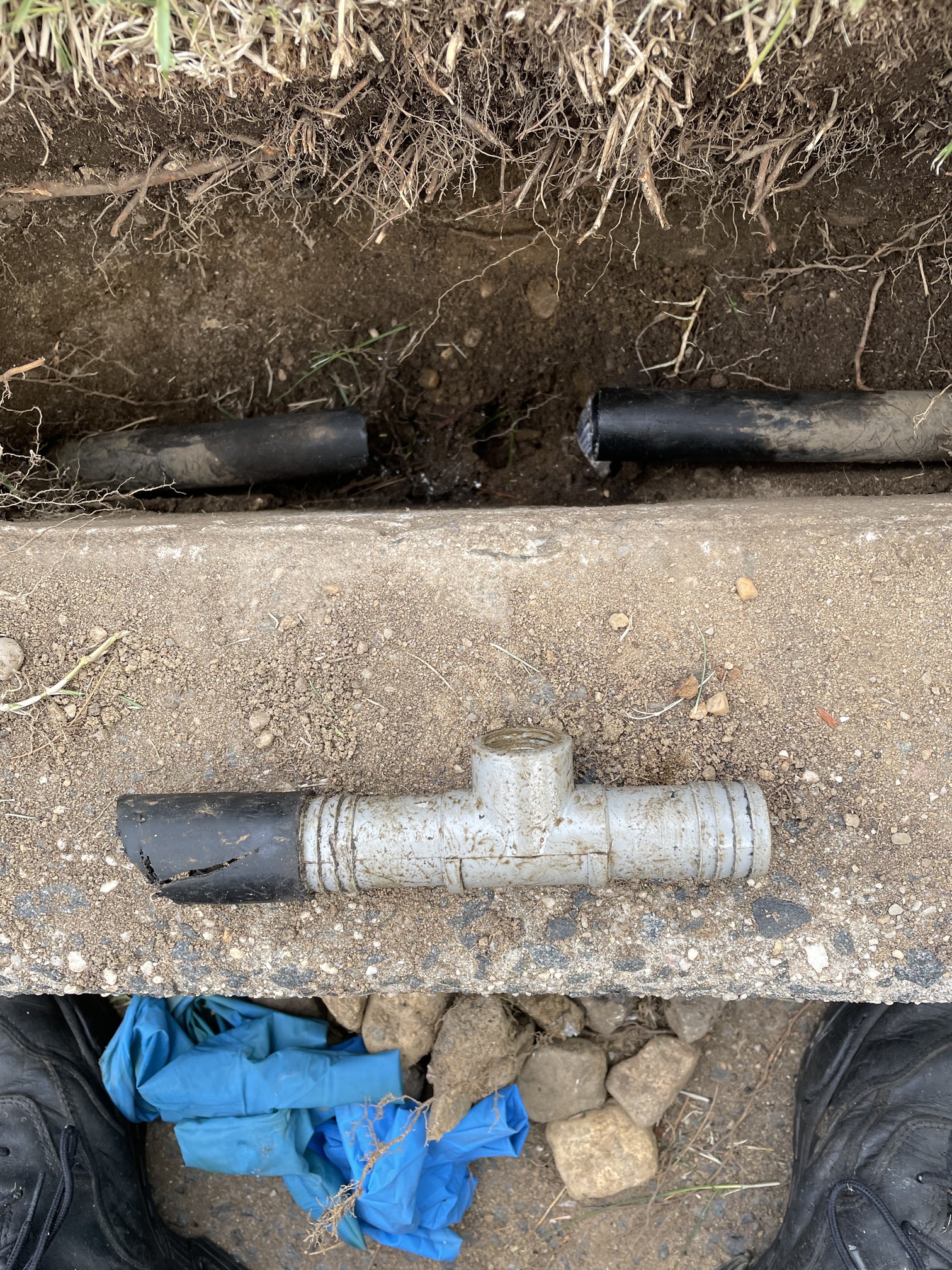

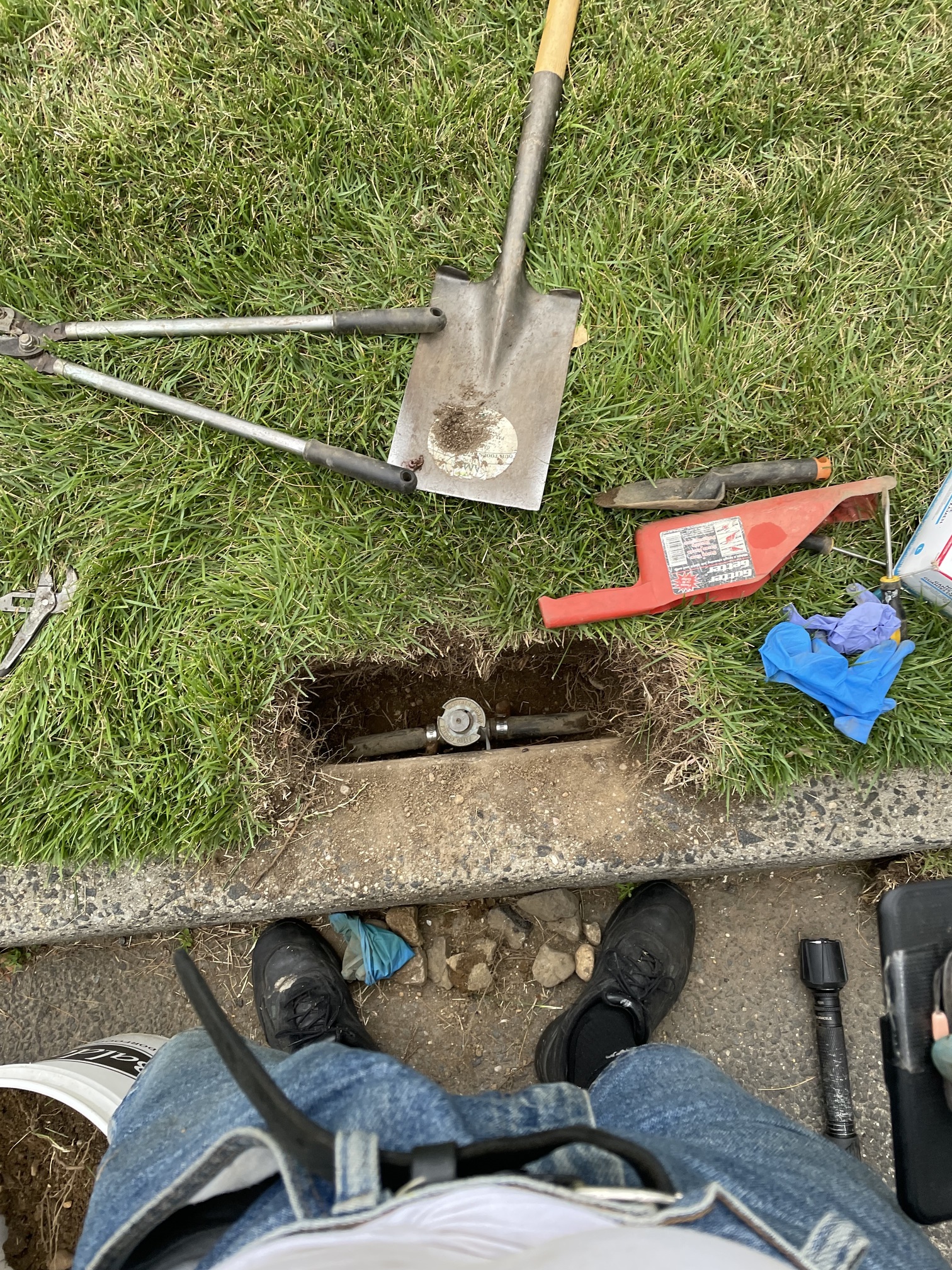

Leaks can be due to multiple issues, like any adjacent trees roots, or even by the weight of those who walk over those sprinkler heads for which the PVC pipes underneath are vulnerable to cut/ breaking; if puddles of water around those area ( when sprinkler in use ) may’ve dig to see those PVC pipes need replacement! Just recently I made those repairs/replacements myself…! Take a look …
