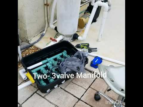

If that is the case, then yes, I guess you can install a standard valve above ground, but there aren’t any 90 degree standard style valves that I’m aware of, so they will all have to be plumbed straight in line. Not hard to do, just a tad more plumbing involved. Typically you would create a manifold system off the backflow device and then plumb everything back into the pipes coming out of the ground from the old indexing valve setup.
Thank you very helpful. This looks sort of simple enough to do below. Do I need the anti siphon valve if I do this?
Interesting setup, but nothing saying that wouldn’t work…
But yes, some sort of isolation backflow or anti-siphon needs to be there. Standard valves do not isolate the irrigation system from your potable water supply (assuming you don’t have a dedicated irrigation meter from the city) and will not pass code in most areas, so you either need to keep your existing anti-siphon valve in place (will need to be set up as a master valve in Rachio), or replace with a true backflow device.
Okay, so what they did there just cutting out the indexer and the antisiphon is wrong, that is exactly what I have BTW. The rest is okay but the anti siphon or backflow device should have been left.
