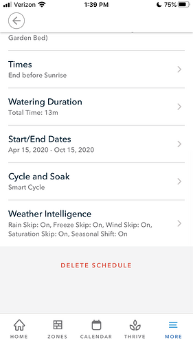

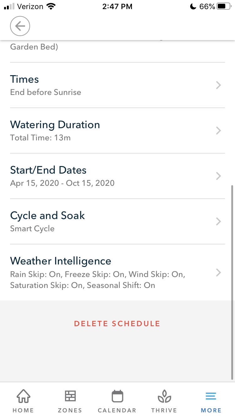

Anyway, I attached a picture of my zone settings for my zone 3 “roses” that have these drippers and a picture of the drippers
I have since set up 3 separate schedules.
One schedule just for my 2 drip zones. I adjusted those times manually. Pictures are attached for my 2 drip zones

Can you take a screenshot of your “advanced” zone settings?
Are you wanting to set up the Flex Daily schedule, or are you fine with the fixed schedules? Only reason I ask is that Flex daily doesn’t work that well if there are severe watering restrictions (looks like you can only water Sun, Wed, Fri).
