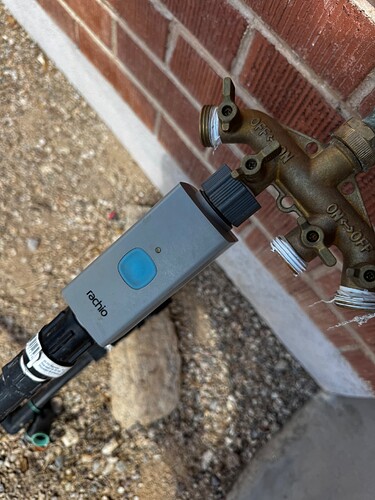

I was able to hold the blue button on the valve for 11 second and did a hard reset. I had to remove the valve and reinstall it as a new unit.
