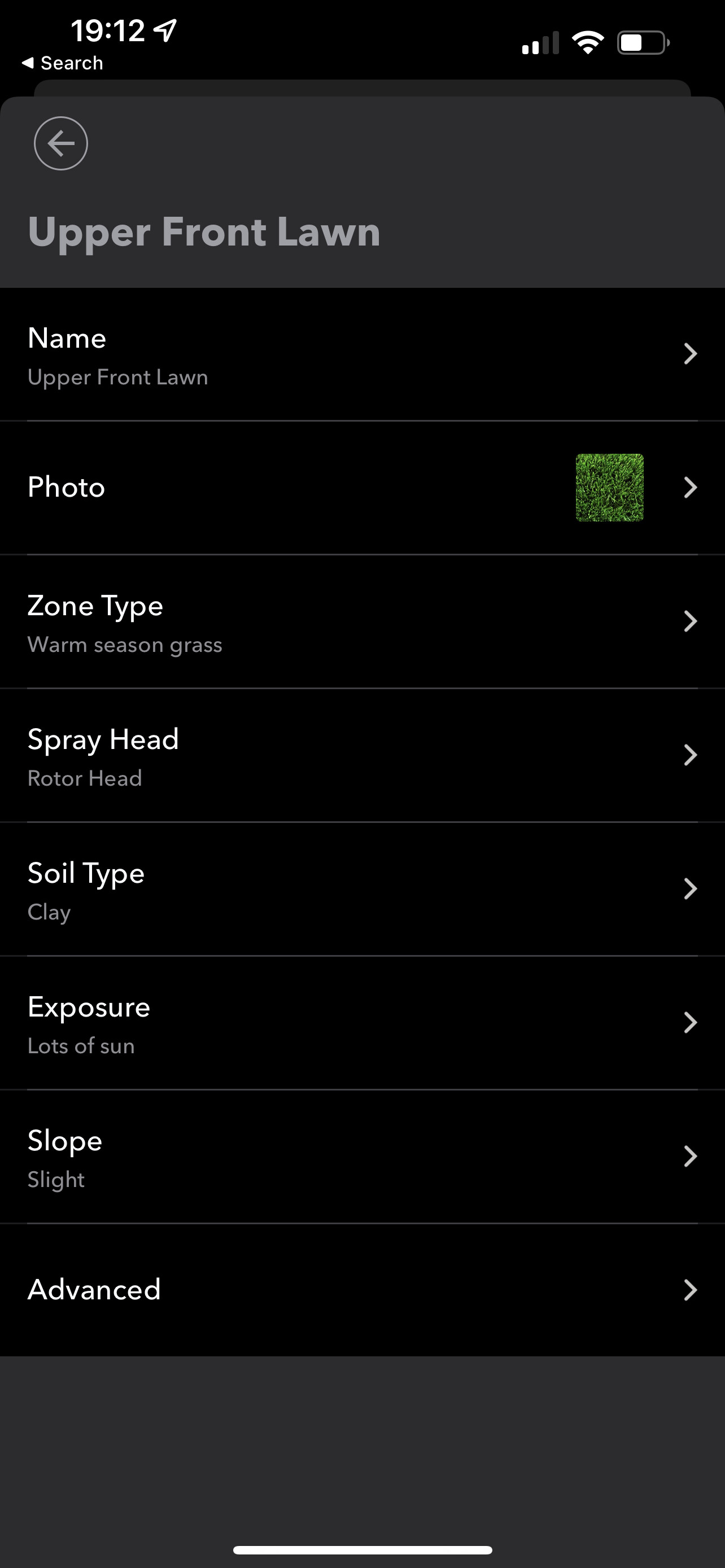

Why not post the details / screen pic of one zone in here. It certainly sounds like you have misunderstood some setting and that is throwing it all off. The issue will be in the advanced settings
The majority of people can operate with default settings available water, allowed depletion (50%) and efficency (80%). You’ll likely set the root depth to 6".
So that just leaves the area which you surely can’t get wrong, and realistically the two most important items and the two that have the most affect on the watering frequency - the crop co-efficient and the nozzle inches/hr
If you have a spare zone on the controller, you could set it up as a dummy and amend setting from the real one and see the effects of changes are in the calculated schedule it creates
Thank you. I think I left most of the Advanced settings at default - but it’s very likely I might have misunderstood some of them. Here are screenshots of 3 of the zones. The rest look and act pretty similar to these. Any suggestions on what I should set differently?
(And yes, I do have extra zones and am happy to experiment with them)
