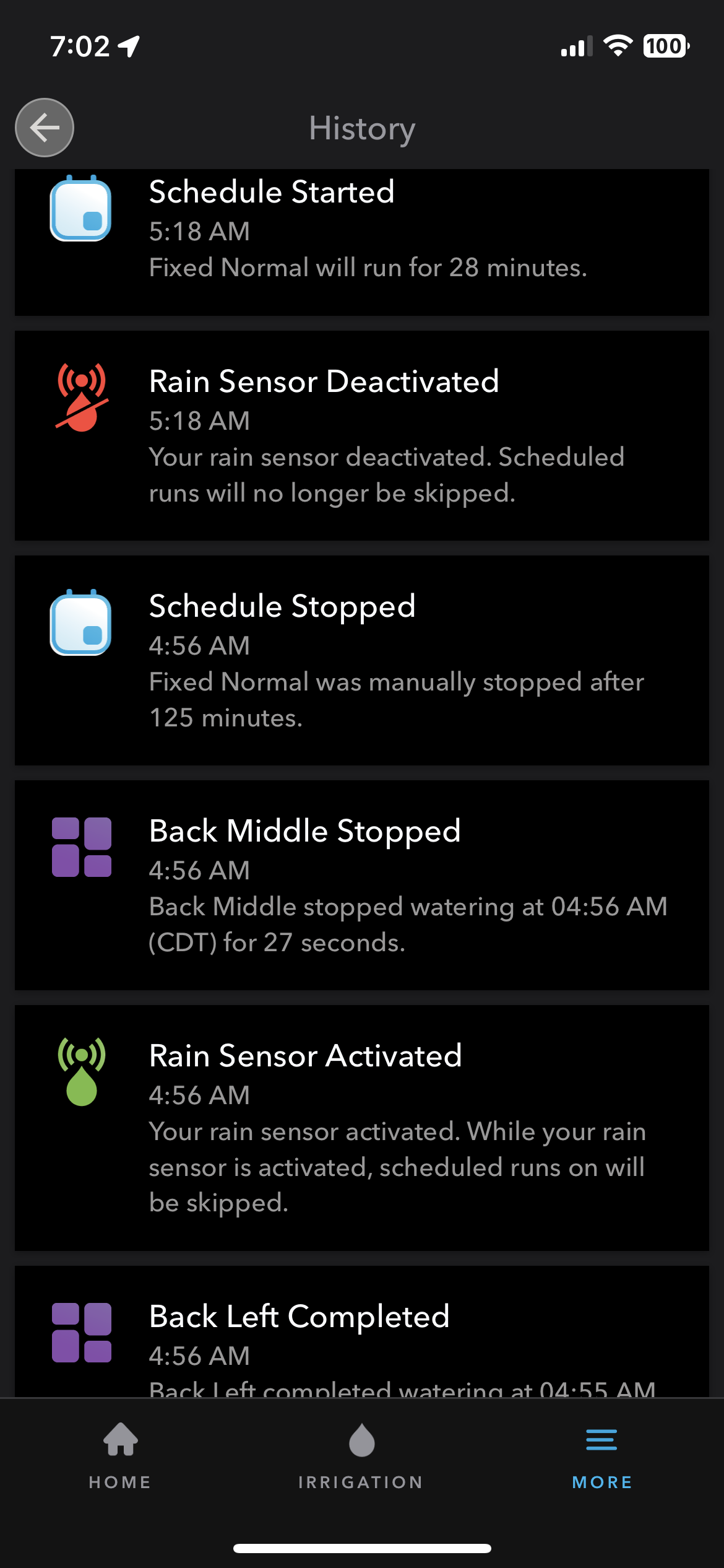

Early this morning the system started watering as normal. It started to rain so the sensor activated at 4:45 AM. The system stopped watering. The sensor Deactivated at 5:18 AM even though it was still raining and the system resumed the schedule and finished watering. All while it was raining pretty heavy. I followed the wiring procedure for the WR2 sensor so I’m not sure what the issue is.
It appears it hardly rained any so your sprinklers finished off their program. That is normal operation.

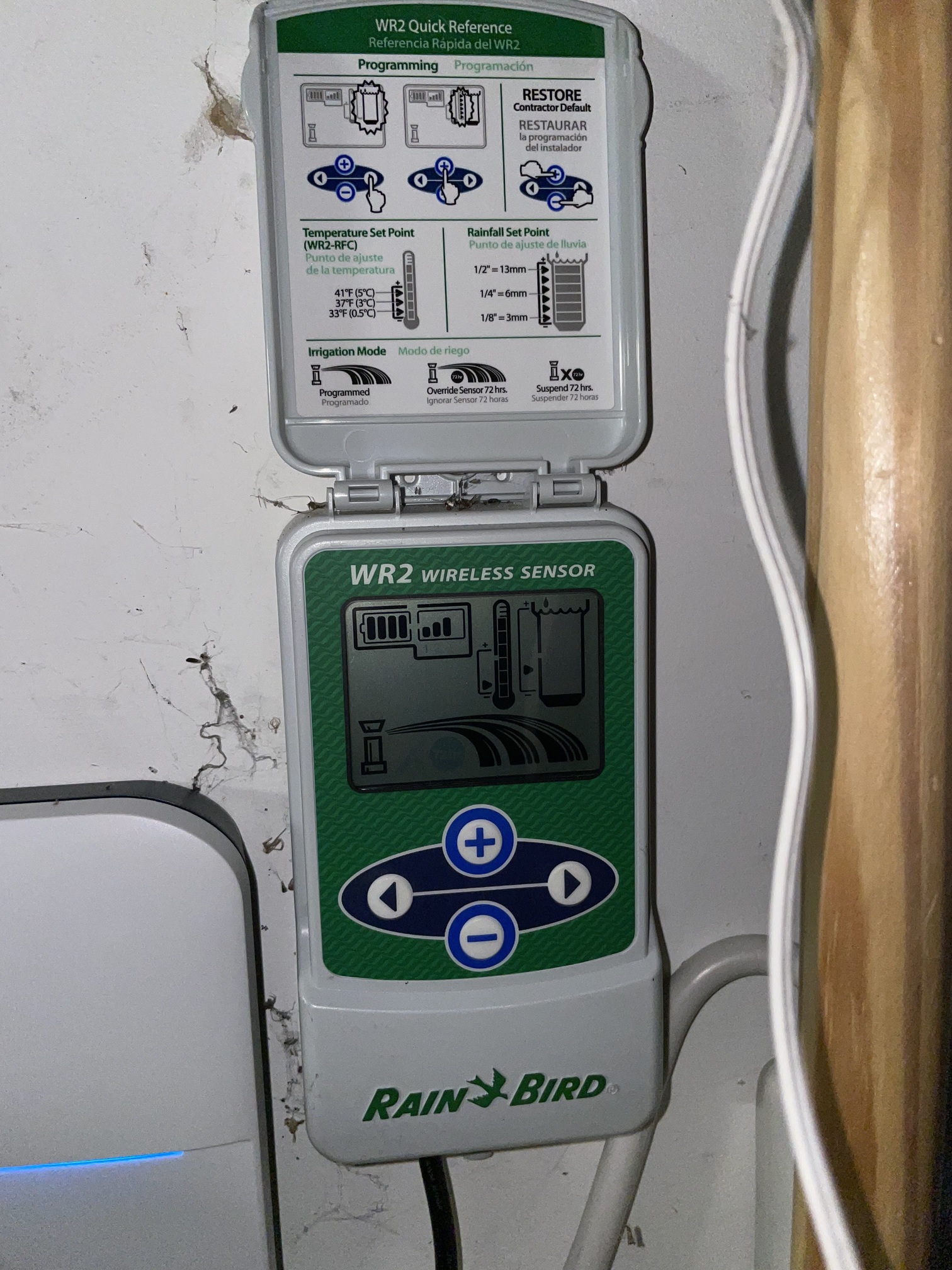

You can lower your rainfall setpoint (it’s 1 notch from half right now) down1 more notch which will trip the sensor earlier and keep them off for a little longer if you wish.
So I just sent up my new Gen 3 rachis and went to connect the WR2 I have, and my WR2 had beens setup with the white wire to the left screw under Sens on the rain bird and green wire to the second screw? I notice you have your white wire tied in with the black 24V wire?
