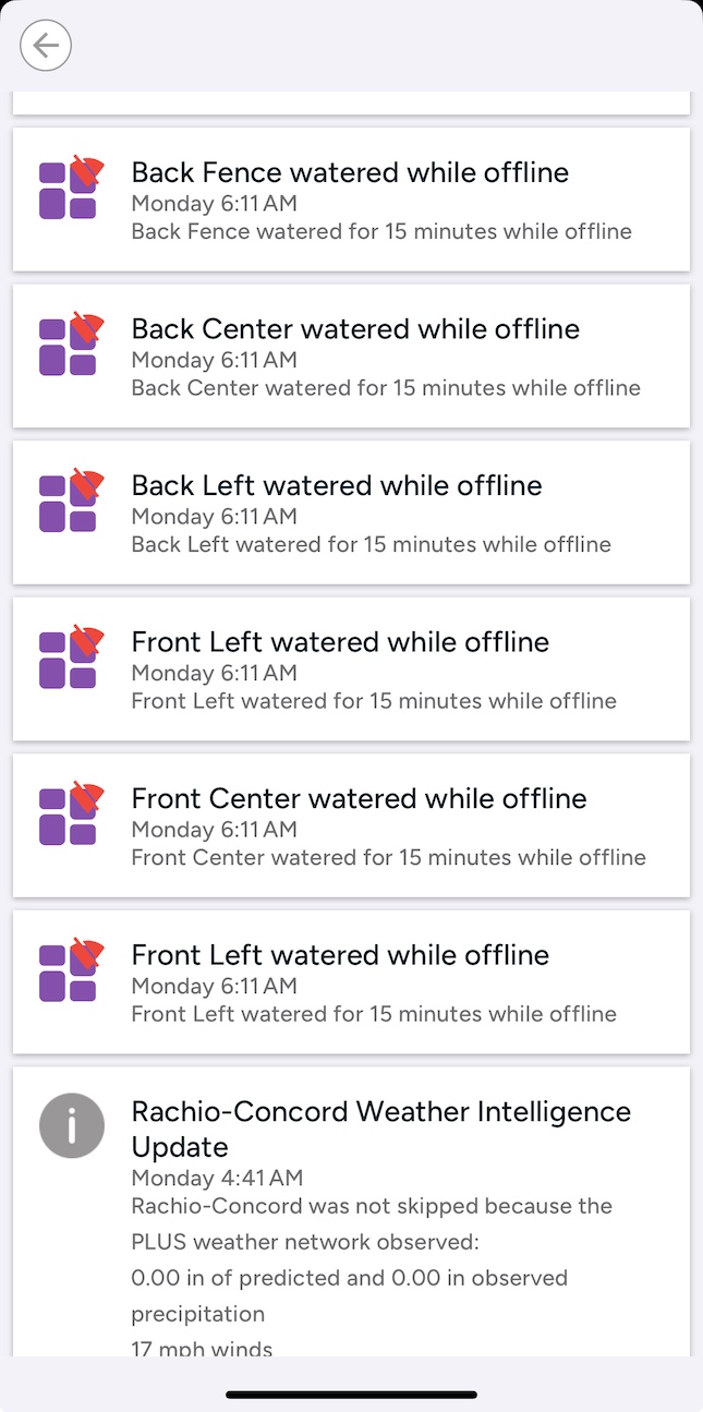

Event History has incorrect timestamp
If a schedule runs when a device is offline, Event History reports the wrong time. Instead of the actual time, it says each zone ran at the moment the device came back online.

It is helpful to know if a device is going offline a lot because the WiFi signal strength might appear okay, RSSI -62 in this case, but it’s glitching for other reasons like router issues.
@jheirtzler
The controller does not send time data with these events, just usage.
