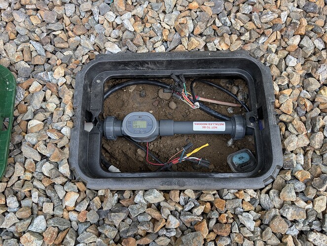

I’d wonder how you’re going to waterproof the flowmeter wiring to low-voltage braided junction. If it comes together, post a picture.
The wiring will all be in a valve box, with the flow meter. The 1" line feeding the valves is only about 4" below the surface, so the flow meter will be inside a valve box. I will just use gel-filled wet location wire connectors to connect the flow meter lead to the shielded pair of 16 ga wires I will use in the cable.

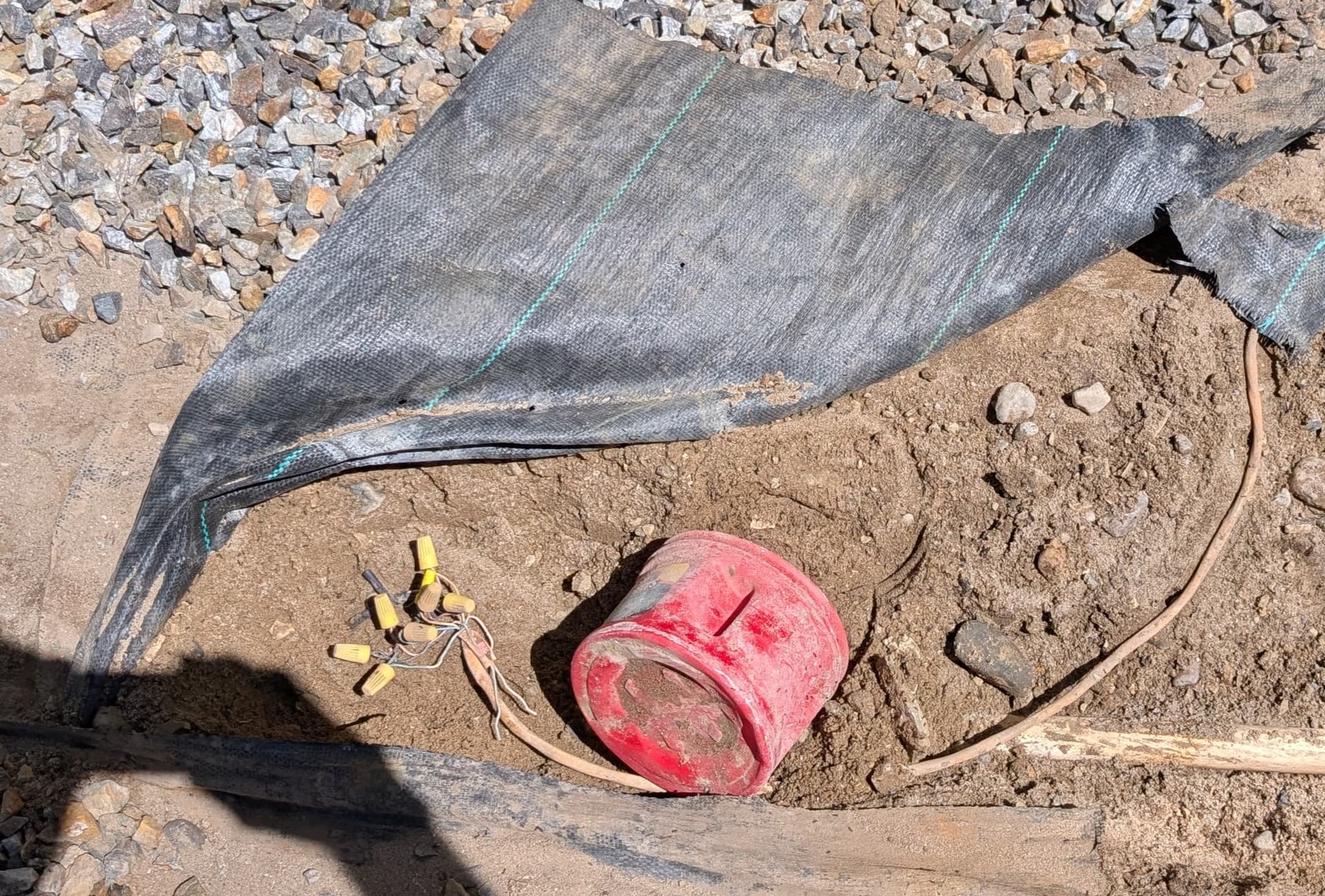

As I was investigating this job, I noticed what I thought was a small valve box under the landscape fabric about 4 feet from where the cable running into the house to the irrigation controller went into the ground. When I moved away the crushed rock and exposed the “valve box”, I found the previous homeowner (I hope it wasn’t a contractor) had “spliced” the valve control cable, used regular wire connectors, and then put a Folgers coffee container over top. The connections were corroded to hell, I am amazed it was still working. So I ran new proper 9 conductor cable to the valves to replace the two 4 conductor thermostat wires they had run to the valves. That spot will now become the location of the new flowmeter, all inside a proper valve box.

Here is the end product - the bare copper wire at the bottom is connected to the 3 drain wires from the signal cable and a 4’ rod pounded into the soil, the valve cable splice is on top. All with waterproof wire nut connectors in a NDS PRO Valve Box - 12" x 17" x 6"
I meant to order a box without tapered sides, so it is a little tighter than I had planned :roll_eyes:
The blue thing at the bottom right of the box is an ant bait trap as I was getting swarmed when I was sitting on the gravel doing wiring. :joy:
All seems to be working beautifully!
