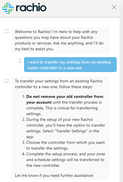

I looked into transferring the settings from the old unit to the new and even used the Rachio chat assistant to verify it was doable (see screenshot).
After spending way too much time trying to figure out how I kept missing the “Transfer Settings” option when installing the new unit, I dug through some older threads here and discovered that transferring settings only works if you move to a controller with an equal or greater number of zones.
