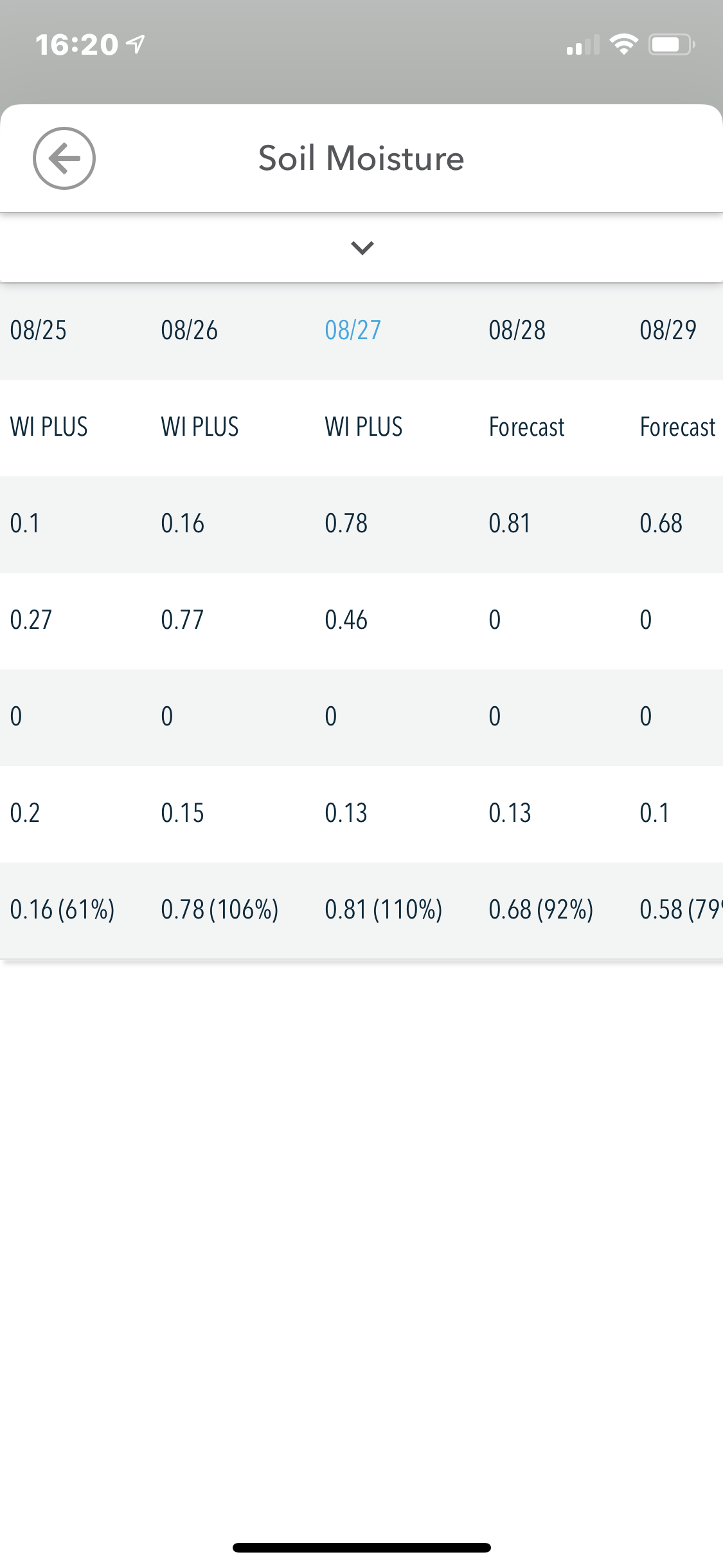

Let’s look at your new chart:
If your zone settings are as you originally posted, except you changed AD to 50%, the system should water 0.16" x 6" x 0.50 = 0.45". Your chart indicates it watered 0.46" today, so that’s close, and I assume it did water today. Looks like the schedule, or you, also watered 0.27" on the 25th and 0.77" yesterday (hopefully it did occur), meaning you are definitely “filled up” with moisture.
Assuming no rain for the next bit, and starting today with 0.81" of water in the zone (110%, the maximum), Rachio is saying your yard will dry out by 0.13" tomorrow, and 0.1" the next day. Let’s assume a 0.13" after that:
8/27: 0.81"
8/28: 0.81 - 0.13 = 0.68"
8/29: 0.68 - 0.10 = 0.58"
8/30: 0.58 - 0.13 = 0.45"
9/1: 0.45 - 0.13 = 0.32"
9/2: 0.32 - 0.13 = 0.19"
9/3: 0.19 - 0.13 = 0.06:
9/4: 0.06 - 0.13 = -0.07" if didn’t water 9/3
Since 9/4 would go below zero (inches or %), your system would water that zone on 9/3, or 6 days from today. Let’s continue, saying it did, and the 0.13 continues:
9/3: 0.19 - 0.13 + 0.46 = 0.52"
9/4: 0.52 - 0.13 = 0.39"
9/5: 0.39 - 0.13 = 0.26"
9/6: 0.26 - 0.13 = 0.13"
9/7: 0.13 - 0.13 = 0"
Since 9/7 would result in zero moisture or less, I /think/ the system would again water on 9/6, but it might wait until 9/7. With a constant 0.13 Crop Evapotranspiration, the system will water every 3-4 days, which is closer to the expected frequency (6 days above is from being oversaturated, along with cooler than normal weather.
You may think back on the heat we’ve gotten, and think that every 3-4 days isn’t enough, and you’d have been right earlier this week. CEs ran from 0.19 to 0.20, meaning your system would water about every 0.46 / 0.20 = 2.3 days. About every other day in hotter weather, it’s just been a bit cooler and more humid lately, so the soil loses less water.
Assuming your system is putting out the Nozzle Inches of water per hour that is selected (under Advanced settings), I think your system is probably adjusted okay now, and things should start greening up. But that Nozzle Inches per hour makes a lot of assumptions, and I think it can be a bit high (making your controller think you’re getting more water than you really are). If the lawn continues, in your opinion, to be a bit on the dry side, try /reducing/ the Nozzle Inches per hour, maybe by 10%, to increase watering time by 10%
Hope this helps. Let me know if you need clarification or anything else.
