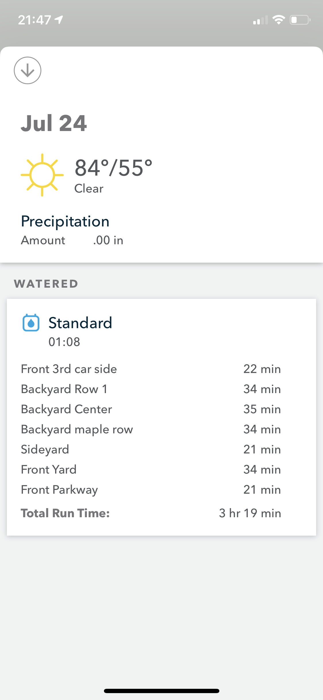

Right and I’ve wondered the same. But the usual runtime is less than 4 hours. If I force the start time it will run on the correct day. Just don’t understand why it suddenly is trying to start in the evening of odd days. Here’s a July start time and an August one as well

If you look at the start times they are very different. The July start time is 01:08 so presumably it started on an even date. But the August start time is 20:55 so that pushes it back so it starts on the previous odd date. Perhaps I am wrong, but it seems to me that something changed between July and August to change the start time.
